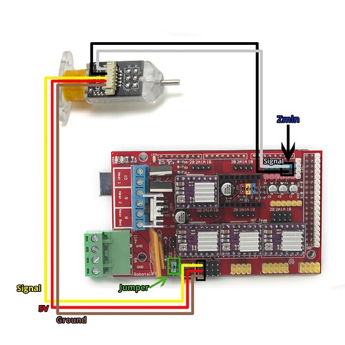

The BLtouch section looks legit:
[bltouch]
sensor_pin = ^PA8
control_pin = PC4
x_offset = 26
y_offset = -2.9
stow_on_each_sample = False
probe_with_touch_mode = False
z_offset = 0
Have you checked the wiring?
The 3 wire cable has to go to the BLtouch connector on the board and the two wire cable (according to your setting) to the Z+ endstop connector.
Hi there
yes i have double checked the wiring, the 3 wires are at the BL touch points and the 2 wires are at z+
Unfortunately the cables are not colour coded, so it is hard to decide if the plug is in the wrong way.
I did plug it in reverse but it came back with an error failed to read state when I plugged it back it gives the error failed to deploy
You may check if the black wires are connected correctly according to this:
Checked it all and the pins are in the correct place from 3D touch to the board they are actually on PA11 I’ve changed the pin output but still no luck
I managed to get to probe working when I use the query_probe pin up , it goes up and when I use the query_probe pin down it goes down but when I try to home G28 it reports failed to deploy BL touch and the probe is coming back as triggered after I use the command Query_probe
solution was that the z-end stop was not plugged out and the 3d touch was in the pin above so all i needed to do was change pin allocation and it worked.
