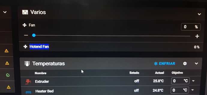

klippy.log ???
A couple of days ago I bought a btt pad 7 and I’m starting with a magna 2 300 that I already had before with marlin, it’s already working and I’m doing various calibrations until I got bothered by the noise of the hotend fan that I would swear that before when I used marlin it wasn’t on until the hotend rose to temperature, I think I managed to upload the only information about the pins of said board that I could find, well, my question is… how do I tell that fan to stay still until it’s time to spin?

Well, I opened it there, the cable that I marked in violet is the fan that is at the base and always running, it is connected to pin J10, in J15 there is the green cable and in FAN PB1 there is the orange cable
These are the cables coming from the carriage where the hotend is located: Orange cable on PB1 is the fan cap (I already tested it)
Blue cable on TH1 PC1 (???)
Brown cable on HE0 PC3 (I assume it must be the hotend thermistor) Green cable on 12/24V J15 (This is the hotend fan cable. If I put it in “HE1 PB0”, will I be able to control it later in Klipper so that it is not always on?)
The blue cable should therefore be the heater cartridge cable
It appears you were wrong Your hotend fan is connected to always on power.
BTW- Brown pair is extruder heater. Blue pair is extruder thermistor. Green pair extruder fan. Orange pair part fan.
Yes. Mind the polarity. I’ll caution you to not try more than simple on/off control as stuck filament in the top of your heat break is no fun at all.
Thank you very much. I managed to get it working by connecting the green cable to PB0 and after saving this code
[heater_fan hotend_fan]
pin: PB0
heater: extruder
heater_temp: 50.0
fan_speed: 1.0
It only works when the extruder heats above 50.0, and when it cools below 50.0, it stops.
