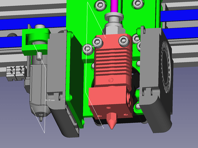

Just a quick update (if you care).
Everything seems to be working okay BUT when I was putting everything together, I grabbed what I thought was a stock/standard Ender 3 hot end but it’s actually not - it’s 2-3mm longer than a stock Ender 3 hot end and the nozzle extends below the BL Touch trigger point.
D’oh!
I’ve tested the Z Axis probing and the quad gantry level using a block to keep the nozzle from coming into contact with the bed and things seem to work fine.
I’ll replace the hot end tomorrow and let you know how it goes.
I was really hoping to start a print tonight.
A quick fix it’s a spacer or some washers for BL in order to lower the trigger point.
