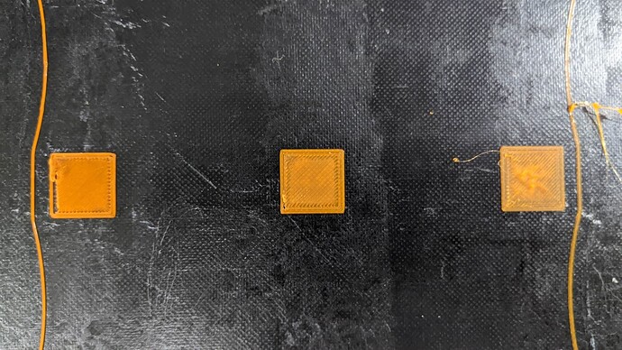

I have tried several times to get a proper bed mesh and have fine tuned the z axis but it still just prints high and low all over the place.
I don’t know if this helps but here is my current printer.cfg,
4-30-2023 printer cfg.txt (14.8 KB)
Here is a picture of the print.
e: The outer square really shows how its all over the place on the height.
Note: I had to stop the print because it was making a mess. Its like it just wont even use the bed mesh at all…

The prior pic you posted of the first layer honestly doesn’t necessarily look like a bad mesh, it could just be a combination of dirty bed and needing to dial in your Z offset. Hard to tell if that’s PETG on glass but in my experience, I’ve had the best results with that combination using the untextured “bare” side of the glass plate with a light coating of the cheapest hairspray I can find. Those sections of the squares where the extrusion lifted at the beginning of perimeters looks like what I see when my Z offset is too high or when I’m trying to print on glass without hairspray. The one in the upper left where a section of the solid infill just didn’t want to stick looks about the same, or when there’s dust or some other substance on the bed surface.
If it were me, I’d wash and dry the glass bed with dish soap and water, then lightly coat with hairspray and try again, doing the first layer extra slow and using baby stepping to find the right z height where everything sticks without squashing. Then you can compare that with your Z offset setting and consider making the change permanent.

I am still having an issue when getting (the baby step) z adjustments dialed in that one side is high and the other is low. This is with the bltouch being all brand new configured with x, y, and the z dialed in real well. like, if I make the z perfect on the left side later when it prints on the right during a bed level test the right side will be high and squish. so far its been the consistent issue that is replicating each time I print. I thought that the BLtouch is supposed to calculate a perfect bedmesh and then the fine adjustments that I make to the z axis will apply to the bed mesh model for the entire bed, right?
I do the probing for bed mesh and its still coming up (at least) +/-.020 from the far left to the far right. If I used even more of the bed the variance would be higher edge to edge.
I am printing with a 0.2 layer height with the initial layer at 0.3 and the width 0.4 but I don’t think that should matter much because isn’t the bl touch supposed to build a proper bedmesh to account for all the divination?

e: I just noticed that my BLtouch might be outside of the min/max range shown in red on this diagram. My bltouch mount my be complete garbage. it was an old print from when I was using larger nozzles.
Yeah so these are my results. It’s all the same. :-/ left side low, right side high. Despite turning off my hardware z end stops and then setting up the bltouch as a virtual end stop and despite running all the same configs and offsets recalibrations that I had been running over and over again it’s still giving me with left-side low and right-side high.

I tried cleaning and flipping the build plate and used hairspray but it was the same issue. left side low and right side high despite calculating the offsets again.

GOT IT!!
SO, it turns out that it was the distance shown in red on this image. The tip of the BLtouch was just a little bit too low. Like, it was re-measured everything and shaved down the attachment point to the bltouch and now I am able to get it to level a whole lot better. Its still off, like it’s low on the left and high on the right but its off by a manageable amount.
