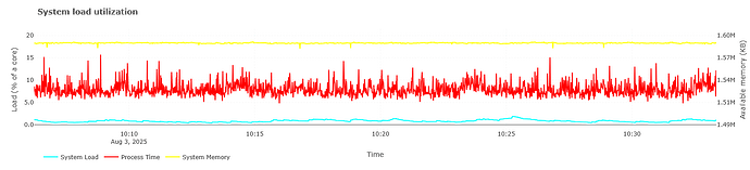

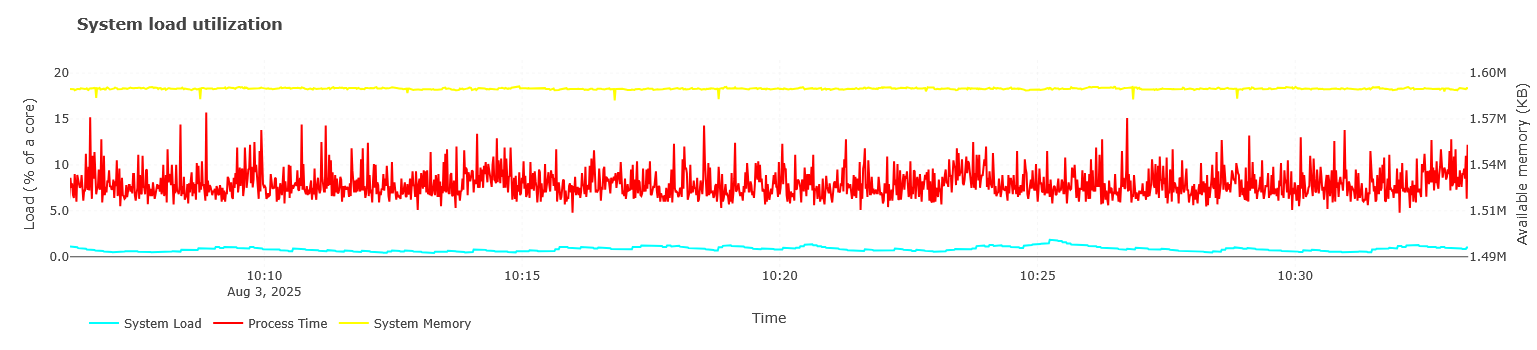

@Sineos What about your answers am I not reading? I do understand what you are saying about the issue. I will refrain from to reduce the size of my responses and will address everything here to make sure you understand that I have read what you have written both in this post, and in the previous posts you have referenced. If you read my response to the posts from @hcet14 I had already responded to the issues in the “timer too close” post. Referencing the entire page again doesn’t address my initial answers to that suggestion as I thought I had been explicit in answering the concerns raised.
Timer too close
1- High CPU or system load on the host - CPU utilization on the host is less than 50% so I don’t think this applies, but please correct me if I’m wrong.
2-High disk activity or SD card issues - The OS is installed on the eMMC. I don’t have read/write stats on it’s usage, but again I don’t think this applies but correct me if I’m wrong.
3-Memory swapping due to low free RAM - Similar to issue #1, utilization is less than 50% so I’m assuming this isn’t an issue. Again, please correct me if I’m wrong.
4-Overheating and CPU throttling - Just like the previous issues, I’m not seeing any overheating on the M8P. It’s in a separate enclosure with forced air cooling that is separate from the printer enclosure. From what I see temps never get above 60c. The EBB board is in a 50c enclosure so it will be “hot” but since it’s not involved in this error it should be able to be discounted.
5-Undervoltage conditions - No under volt messages are present.
6-USB, UART, or CAN wiring faults-Since this branch of the CAN network consists of the USB connection between the CB2 and the M8P any wiring fault would be a hardware fault on either/both boards. This is unrealistic for me to troubleshoot and since they are installed in an enclosure and stable, flexing from thermal expansion would be the only cause of an intermittent fault. This is a possibility but there is no correlation between load/temps and the errors.
7-ElectroMagnetic Interference (EMI) - Again, a possibility, but since the boards are in a grounded enclosure separate from the PSU and at least 2m away from any other machinery, the boards themselves would need to be the ones putting out the EMI. Which would indicate a much more severe defect than a broken trace/pin. Again, please correct me if I’m wrong. None of the other equipment in the room was powered on when the error occurred.
8-Conflicting USB devices (e.g. webcams, displays, hubs) There is a USB camera and a touch display connected to the board via USB/HDMI. The error has occurred when there was no USB devices connected. I’m happy to disconnect the camera and/or the touchscreen and let the error happen again to prove if necessary. This is another possibility, but the error has occurred with and without these devices connected, so I’m skeptical at best this is the root cause.
9-Incorrect firmware Clock Reference setting - The devices are working correctly normally. An incorrect clock reference would not function at all.
10-Running Klipper inside a Virtual Machine (VM) - NA
11-Poorly written macros or command spam from slicers - no special macro are used that could possibly cause this. Errors happen with files that also print successfully. Errors happen with small and large prints, there is nothing consistent about gcode files that causes the error. Files from multiple slicers have caused the error.
12-Unofficial modules or patched Klipper forks - The CB2 requires the BTT fork. This is my guess at the root cause. I have another CM4 coming, hopefully soon, to try an official klipper installation.
If there is something else in that post I’m missing, please enlighten me.
