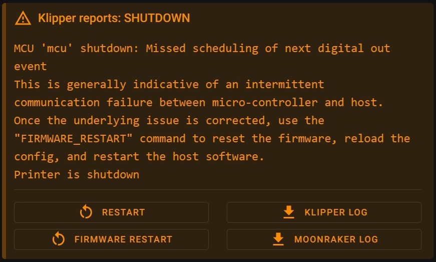

CAN network failures - M8P CB2 EBB42
In case it helps:
I’m not sure where you find any CAN errors in your logs.
Again, the sequence of events is:
  1. The system fails with “MCU ‘mcu’ shutdown: Missed scheduling of next digital out event”
  2. All errors logged after this initial error and up to the next restart are to be disregarded
  3. The attempt to reconnect fails, but it fails for the main MCU, which supports the theory that the “something” caused “something else” which now thwarts new connections and is only cleared with a hard cycle. This could be the main MCU stuck in a bad state or something on the OS or networking level around the CAN interface.

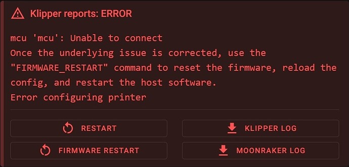

    mcu 'mcu': Starting CAN connect
    Created a socket
    webhooks client 547752869312: New connection
    webhooks client 547752869312: Client info {'program': 'Moonraker', 'version': 'v0.9.3-100-gcea6fbc'}
    mcu 'mcu': Timeout on connect
    Created a socket
    mcu 'mcu': Wait for identify_response
      File "/home/biqu/klipper/klippy/serialhdl.py", line 68, in _get_identify_data
        params = self.send_with_response(msg, 'identify_response')
      File "/home/biqu/klipper/klippy/serialhdl.py", line 262, in send_with_response
        return src.get_response([cmd], self.default_cmd_queue)
      File "/home/biqu/klipper/klippy/serialhdl.py", line 322, in get_response
        self.serial.raw_send_wait_ack(cmds[-1], minclock, reqclock,
      File "/home/biqu/klipper/klippy/serialhdl.py", line 254, in raw_send_wait_ack
        self._error("Serial connection closed")
      File "/home/biqu/klipper/klippy/serialhdl.py", line 61, in _error
        raise error(self.warn_prefix + (msg % params))
    serialhdl.error: mcu 'mcu': Serial connection closed

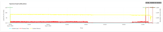

I just put your latest klippy.log through the visualizer tool:
and if you look at the graphs produced, at 10:17:58, something bad happens and system load shoots up:

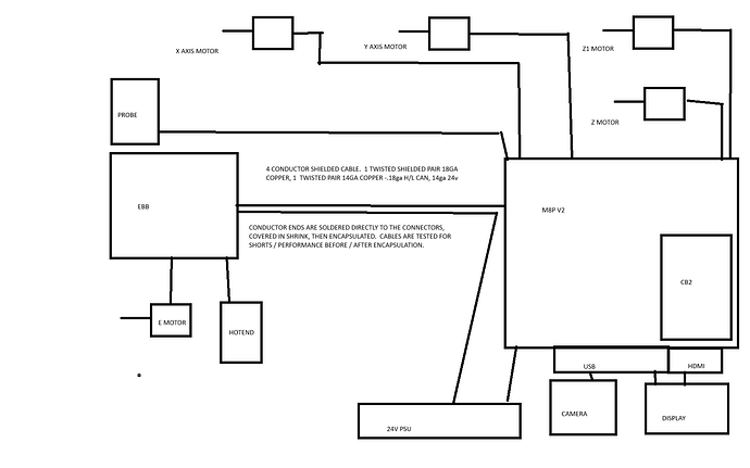

    2. You aren’t forthcoming about your wiring; if you can’t share that information because of an NDA then that sounds fishy to me as you’re doing something unusual

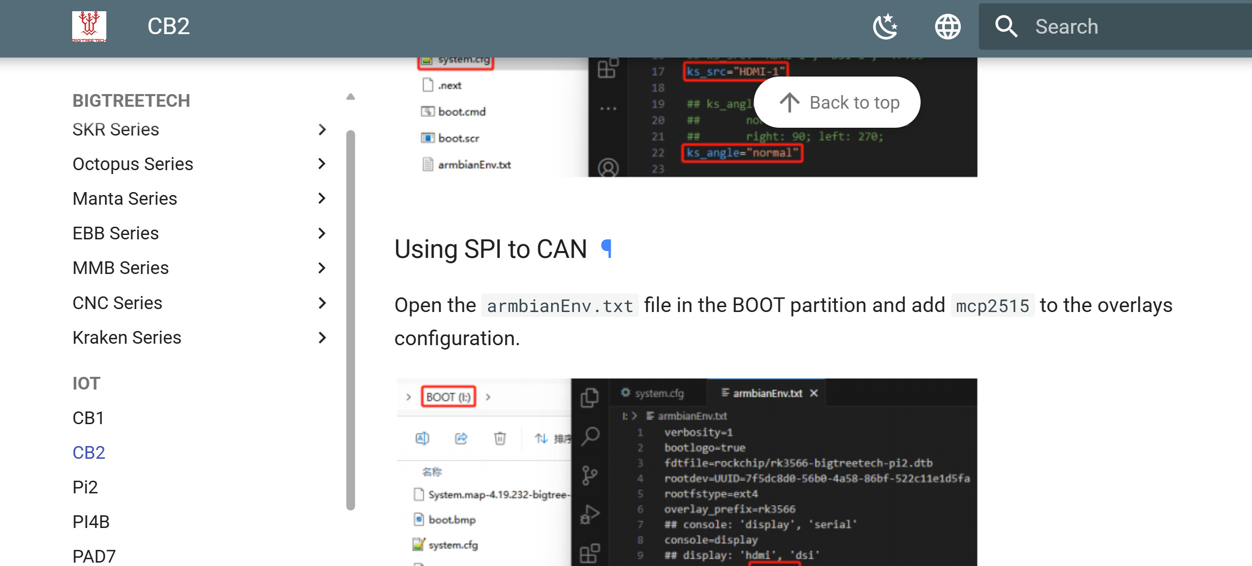

If you read the CB2 documentation you will find that in order to use CAN you have to enable the MCP2515 overlay in Armbian.

    1. The “missed digital out” error
    2. The failure to clear the error
  • Albeit related, No. 2 is a consequence of No. 1, so tackling No. 1 is priority
  • The errors in the klippy.log only describe symptoms as Klipper has no way of identifying a loose connector, broken cable, unstable system, etc.

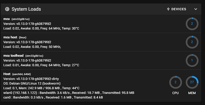

1- High CPU or system load on the host - CPU utilization on the host is less than 50% so I don’t think this applies, but please correct me if I’m wrong.
2-High disk activity or SD card issues - The OS is installed on the eMMC. I don’t have read/write stats on it’s usage, but again I don’t think this applies but correct me if I’m wrong.
3-Memory swapping due to low free RAM - Similar to issue #1, utilization is less than 50% so I’m assuming this isn’t an issue. Again, please correct me if I’m wrong.
4-Overheating and CPU throttling - Just like the previous issues, I’m not seeing any overheating on the M8P. It’s in a separate enclosure with forced air cooling that is separate from the printer enclosure. From what I see temps never get above 60c. The EBB board is in a 50c enclosure so it will be “hot” but since it’s not involved in this error it should be able to be discounted.
5-Undervoltage conditions - No under volt messages are present.

@mykepredko I’m not sure what you’re seeing in the log with that spike. I don’t see that at all even when I zoom in on that section.

You aren’t forthcoming about your wiring; if you can’t share that information because of an NDA then that sounds fishy to me as you’re doing something unusual – I have tried to be completely forthcoming about the setup and the specifics down to gauge sizes of the individual conductors. If you need me to post it again, I’m happy to but I fully described the harness both to @cardoc and again to @Sineos. The NDA covers publicly posting pictures of hardware. I don’t personally think there is anything proprietary about the cables, but I don’t decide what’s covered in the NDA. The only reason I can think that a picture of the physical cabling is needed is that you don’t believe my statements about it. Never mind the fact that this error has NOTHING to do with the CAN wiring harness connecting the M8P to the EBB.

Thanks for the suggestion on the klipper versions. I’ll do an update to the latest version and flash over the new versions to the MCUs. The error has occurred when all versions match, again, I’ll repost logs/errors when it happens again.

My mspaint skills leave things to be desired aesthetically, but I think everything is there for the setup. If you require specifics of hardware I’ll have to check on what I’m allowed to say. Currently everything is from the motion system of a stock Anycubic Chiron with a custom hotend driven by an EBB board. The probe connects directly back to the M8P and is powered by 12v from the M8P through it’s own shielded cable. Shielding is grounded only at the M8P side to ensure a single path to ground for both the CAN cable to the EBB and the probe cable. All cabling from the chiron has been replaced with silicone coated copper conductors. Connector pins are soldered to the conductors and covered in shrink wrap where possible. Only the CAN cable is encapsulated.
I just looked up what the latest BTT CB2 would be: It has a 6.1 Kernel variant. Kernel versions prior to 6.6 may cause issues on the CAN side.
Typically when this issue hits home, one would see a rising bytes_invalid in the log. This seems not to be the case here, but it is worth a try.
Either skip the CB2 and get a RPi CM4 or try building your own Armbian image. According to their commit history, they support the CB2, but do not yet offer an automated build.
