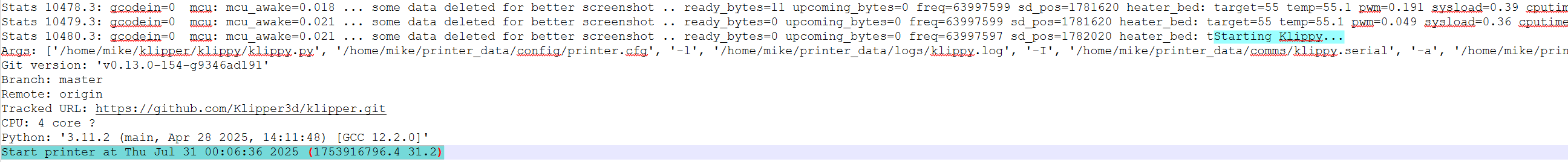

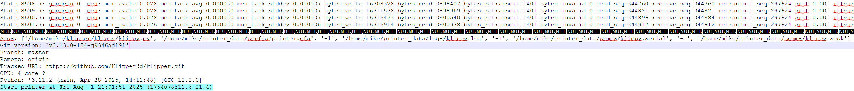

Interpreting klippy.log
The klippy.log file is crucial for understanding what happened. You can find it in your ~/printer_data/logs directory. In a hard crash scenario, the klippy.log will typically show the following:
  • The log shows normal Stats lines, and then it abruptly stops.
  • There is no error message or clean shutdown notice.
  • You may see a line of garbage or null characters. This happens when the system crashes while the log file is being written to, causing corruption.
  • After the SBC reboots, the Klipper service starts again. This is why the log file continues with the full Klipper startup banner (Args: ..., Git version: ..., Start printer at ...).
  • There will be a significant time gap between the last Stats line before the crash and the new Start printer at ... timestamp, corresponding to the time the SBC was offline.
