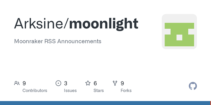

That is Moonraker attempting to fetch announcements from Moonlight. It looks like DNS was redirecting the request to the wrong location which resulted in the cert verification error. From glancing at the thread this is likely a regional issue, and it seems the OP corrected this with a VPN.
As for Klippy restarting, I dont see any relationship in the timing with the SSL errors and Klippy restarts. There are two restarts in the log, one at 1:17:34 and one at 3:17:14. The SSL errors don’t start until 1:47. Moonlight checks every 30 minutes, so the errors continue on that interval until 3:17:22, which is after that second Klippy restart.

Moonlight is a github repo that generates RSS feeds from specifically tagged “issues” for registered projects. Projects like Klipper, Moonraker, Mainsail, Spoolman, etc can create these issues when they want to make an announcement. Moonraker will fetch updated RSS feeds, the feeds are then parsed and a frontend like Mainsail can present the results as notifications.
You may promote it here to get
At this time projects must meet the following requirements:
  • Have a user base of at least 200 users
