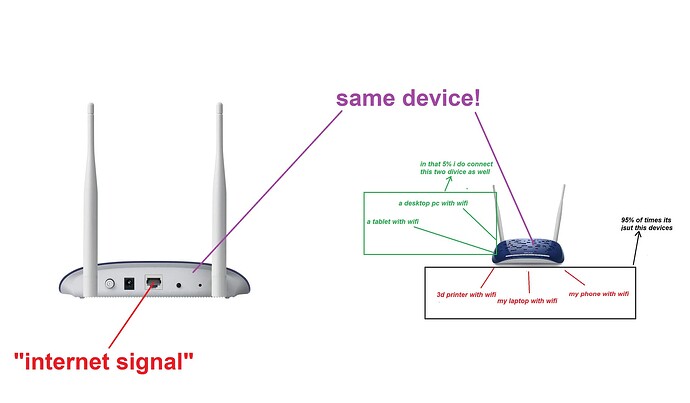

Sorry but your answer didn’t help me. Can you provide a rough picture (schematics) of your network. You said there are usually 2, maximum 4 clients connected. Just tell me how each client is connected (wired or wireless).

about my connection that you asked me to provide as a picture

I would like to have a simple schematics, how your “Internet” is set up by hardware.
Let me try to explain for what I’m looking for.
From you picture it looks like a TP-Link TL-WA830RE TL-WA830RE | 300Mbps Wi-Fi Range Extender | TP-Link . This is a Wireless Range Extender. I guess you connect it with a LAN cable and than you connect all your devices wireless.
If I guess right, than we have this
My questions are:
  • where comes the “internet signal” from? Out of which device! Please provide all info’s from that device (manufacturer and type)!
  • on which device runs Mainsail, when you prepare and start a print?

ints not a
its TD-W8960N 300Mbps Wireless N ADSL2+ Modem Router
TD-W8960N | 300Mbps Wireless N ADSL2+ Modem Router | TP-Link
This modem is connected to the telephone line ( with gray connector near LANs), and I’m not using its LAN ports — just the Wi-Fi functionality.
Everything is connected via Wi-Fi.
From the back, it looks like this:
also about
mainsoil is running on a btt cb1
The btt cb1 is connected to TD-W8960N via wifi
