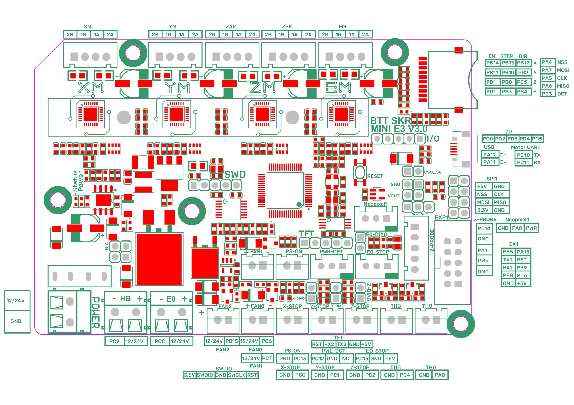

And as for my printer.cfg, I was confused when I selected one. I didn’t know if I should go with the one for my motherboard or the one for my printer, or a combination of both. I’ll try out the one you recommended and see if it helps.
Edit: just noticed that the config you linked is for the v3 board, not the v2. Should I still use it or shop around for another config?
Hi @AgentLoneStar007 ,
You should start with one for the board you’re using since it will have the proper pin definitions. Then, you can copy over the axis limits and thermistor settings from the printer’s config.
I didn’t look super close but I don’t see any pin name changes.
