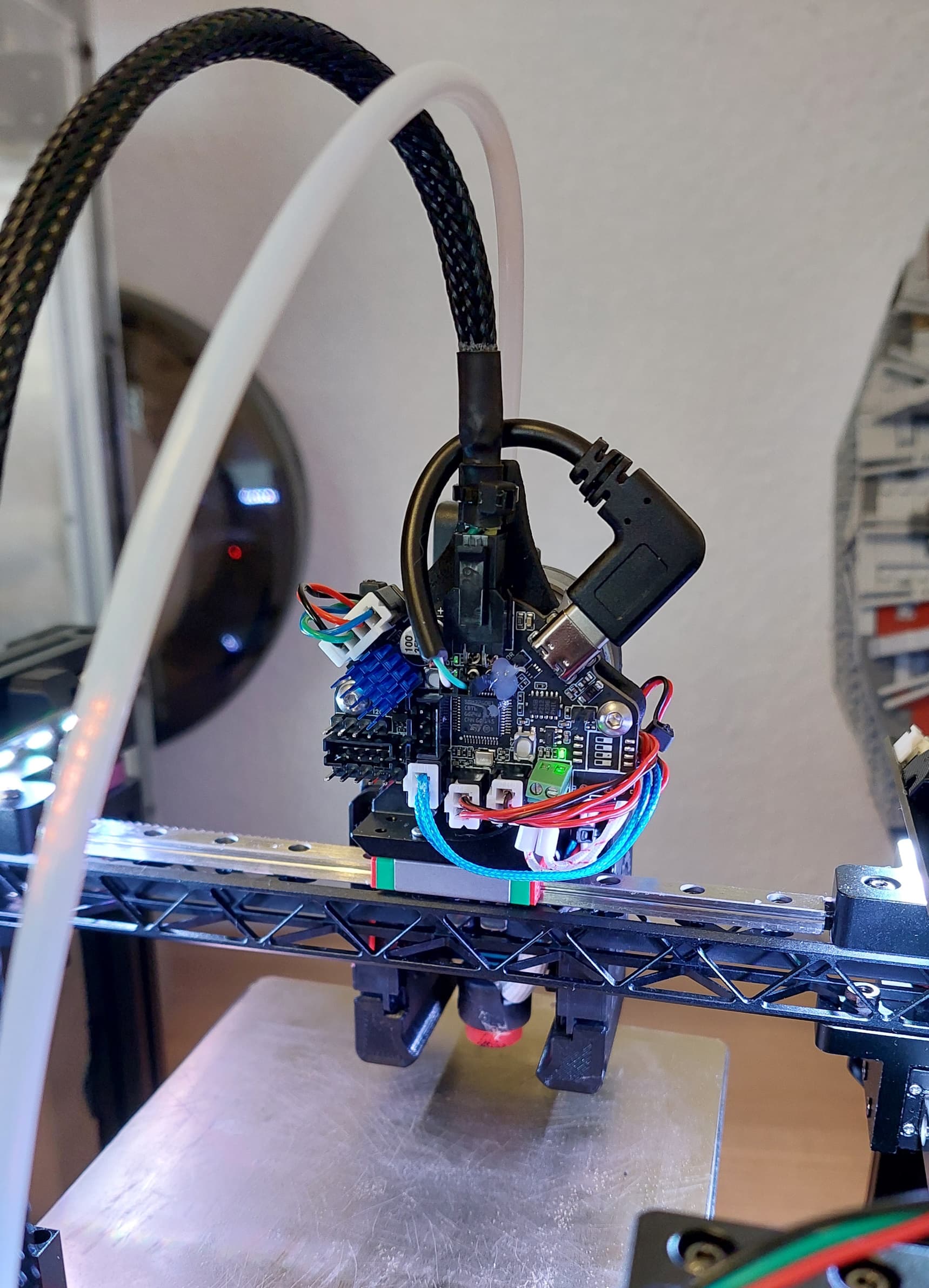

If you rewire your power cables maybe you can cut the whole canbus cable to length to avoid that large loop on your photo, decreasing the effective area/wire that can be influenced by interference and stuff like that.
My USB-connection to the EBB36 seems to work now at least in idle mode but I dumbass did not twist the data lines… Hope it will be stable though. :grimacing:
