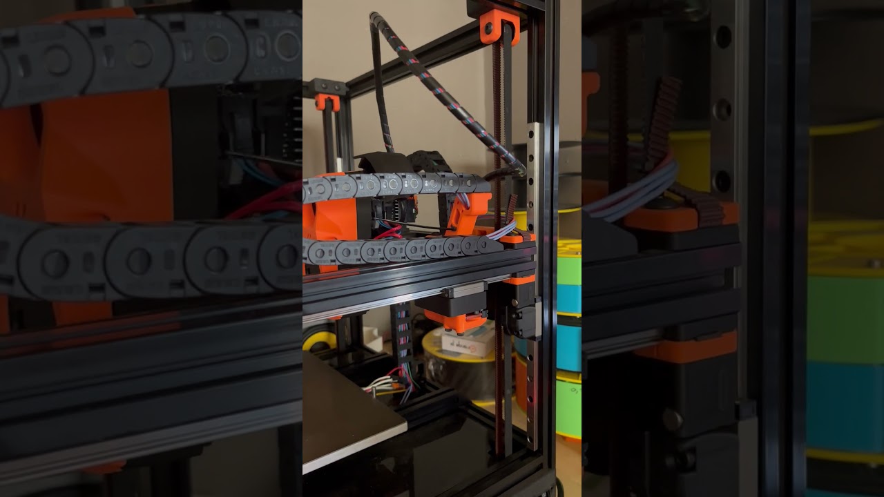

Endstops x en y don't stop steppermotor with the g28 code
Printer Model: voron 2.4
MCU / Printerboard:octopus v1.1
klippy (3).log (3.0 MB)
when i use the g28 code to home my printer , it dont stop the stepper motor .
when i put the printhead manual against the endstop x and y are triggerd like in the picture .
is this firmware related ?
Follow Configuration checks - Klipper documentation
Then verify that the printhead really moves towards the endstop when issuing G28.
If it does not then check Initial Startup | Voron Documentation
made a video of the problem ,
The video is no help, except it seems to move in the right direction. Follow the first link and post your findings.
Home each axis individually to exclude that you have switched X and Y
