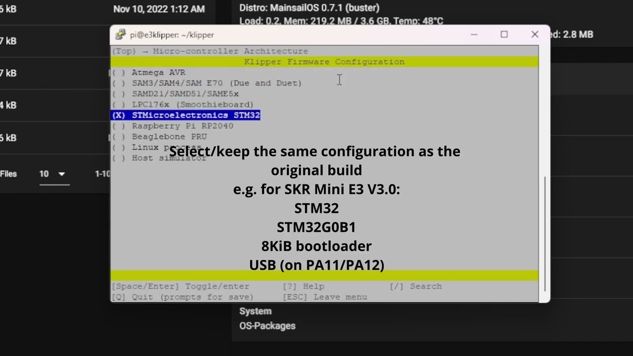

Now, I just took another look at your klippy.log. It looks like you upgraded your Klipper software (you’re running v0.13.0-154-g9346ad19) but you haven’t upgraded your MCU (it’s currently version v0.12.0-410-gcf3b0475).
I suggest you update your SKR Mini E3 V3’s firmware to the latest level and see if the problem with the BLTouch continues.
I have now upgraded the MCU
found this on Youtube
And have now mcu Version: v0.13.0-154-g9346ad19
