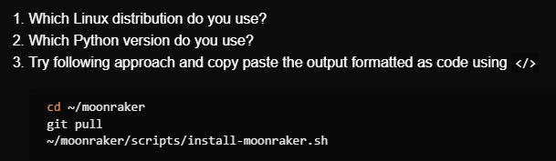

Moonraker updated, performed a print after the update but now Fluidd won’t connect to moonraker. I haven’t changed any other settings or command prompts
See K1C unable to connect to moonraker after update - #2 by Sineos
These Creality machines do not update correctly when a Moonraker dependency changes. Yesterday I pushed a change that replaces an unmaintained library (dbus-next) with a maintained fork (dbus-fast). On normal machines the new dependency is installed during the update. It appears that Creality machines do not install Moonraker in a proper virtualenv with pip installed, thus the failure.
Thanks @Arksine. Yes, it looks like a dependencies / installation problem.
This machine seems an Ender, so I was more referring to:
to get an idea what is actually happening during installation. Python version according to the log is 3.8.2, which should be compatible with the recent changes.
@LDD is this a Sonic Pad?
I’m guessing its either a Sonic Pad or the Klipper Edition of the Ender 3. From moonraker.log I can see its a MIPS processor running Creality’s custom linux build. Unfortunately the install script won’t work for it. Someone created an issue with a solution.
