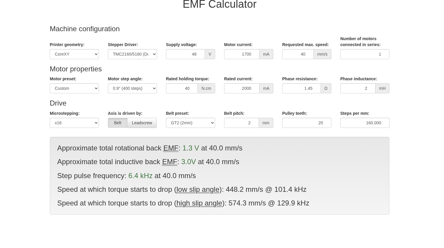

there is no Klipper, Kalico, Voron or something.
There is TMC.
Stallguard measures back EMF.
Higher the speed → higher the back EMF.
Higher current → higher the back EMF.
Normally, you do just set your rated current, play with speed and acceleration and it should just work.
Normal SG2 values -10 < 0 < 10
https://www.analog.com/en/resources/app-notes/an-002.html
That is it.
You do have 0.9-degree motors, so probably you can work with 20 mm/s or higher.
For a normal 1.8 degrees, I would say 40-50 is more adequate.
Same for the current, you do have high current drivers, you do have high current motoros.
With a high chance, they have to run at 1.7A to work adequately.
(look at back EMF numbers).
Hope that helps.

Exactly… and this the point of the post. That’s what should happen, but it doesn’t happen and I’m trying to determine why or at the very least not determine why and get a comfortable/safe, but faster homing speed like every one else.
With your suggestion, I re-ran some test:
driver_SGT: ∆             ; (-64 — 63)
home_current: 1.7         ; (0.8 — 2)
run_current: 1.7          ; (0.8 — 2)
homing_speed: 40          ; (20-100)
Notice, the only thing changing here is the SGT value.
Test 1.
  • -64, -50, -40, -30, -20, and -10 = stalls.
  • At sgt 0 the toolhead became unstoppable so I had to emergency halt.
Test 2.
  • -5, -4, -3, and -2 = stalls.
  • At sgt -1 the toolhead became unstoppable so I had to emergency halt.
Test 3.
  • 10, 20, 30, 40, 50, and 60 = the toolhead became unstoppable so I had to emergency halt.
