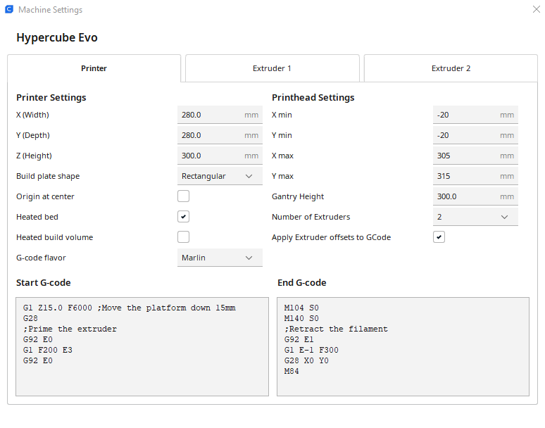

You may insert a G28 into the slicer’s start script
I added the G28, still starts print in front of bed…

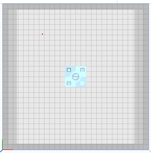

How did you set up your slicer?
grafik
yep, Bed setup as rectangular, with origin in the front left corner.

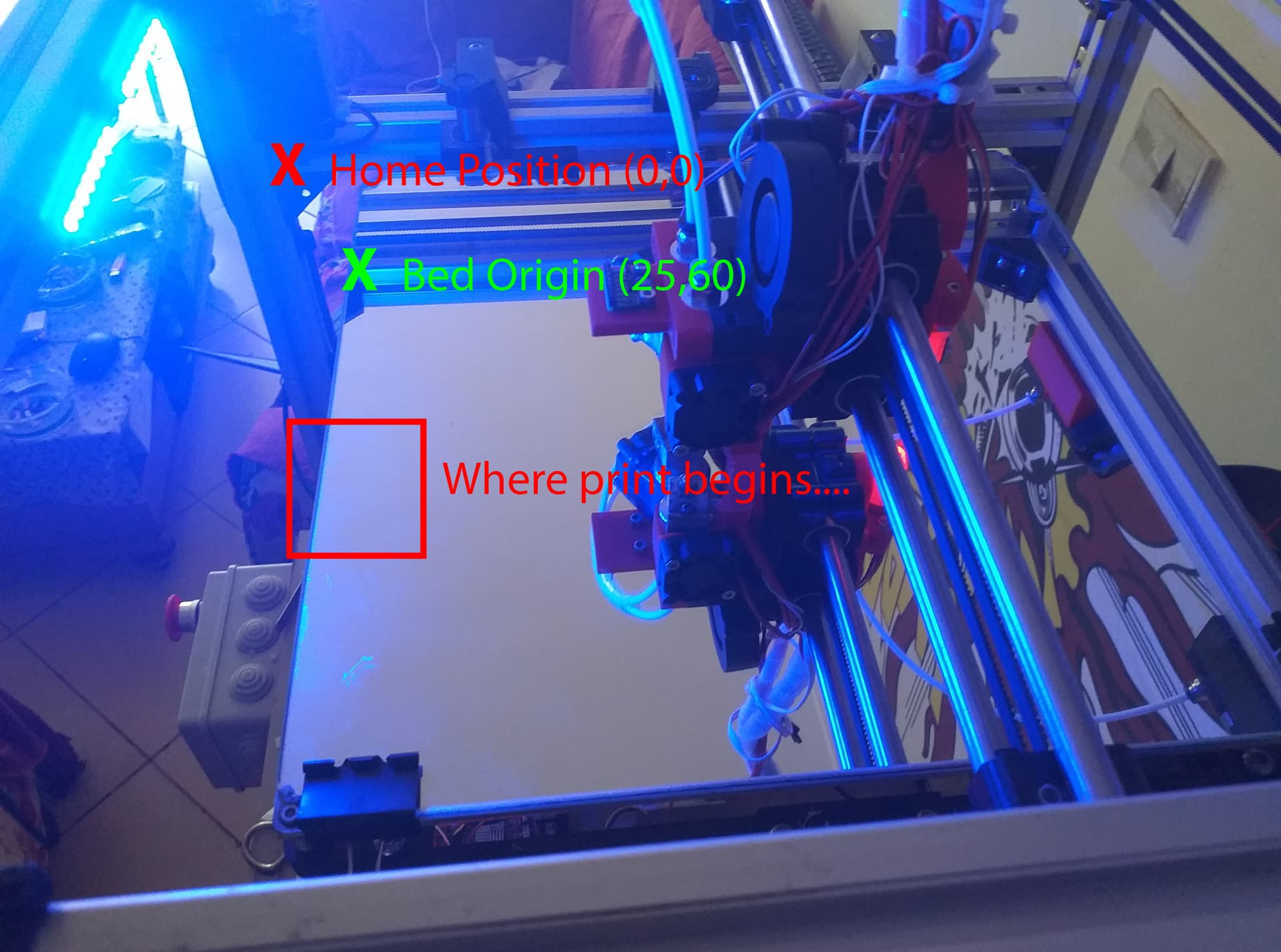

Now back to the start of print problem, here are some screenshot and picts to make it more explicit!

So, where in Klipper, or in Cura, can I tell the printer to move to the bed “Origin” (25,60) after Homing… ?
If the bed origin corner has a distance 25/60 from the endstops, then you have to use negative values for the endstop positions:
[stepper_x]
position_endstop: -25
position_max: 305
[stepper_y]
position_endstop: -60
position_max: 340
The max positions according to the size values in the slicer.

I forgot! You have to set position_min too with the value of position_endstop
That’s one problem sorted, now printer does’nt start before the bed!
Thanks a lot! :raised_hands:
