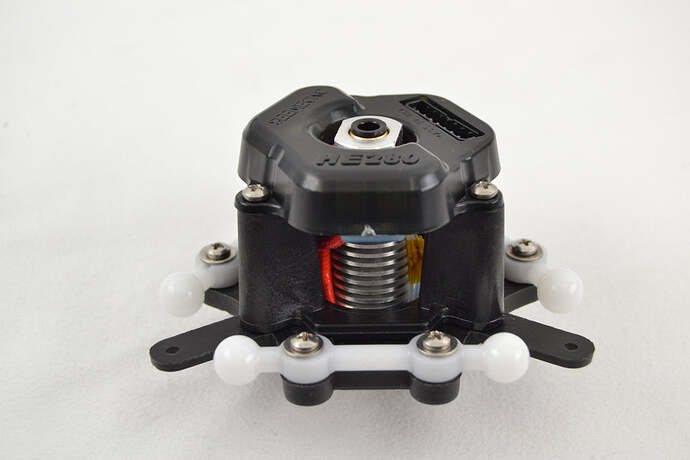

SeeMeCNC tried this with the delta Rostock Max v3:
I tried using it on my v2 years ago and it never quite worked correctly. The biggest issue was repeatability as flex in the system (hotend, gantry, bed, etc) would change the accelerometer’s response. Not to mention, watching/hearing the nozzle hit the bed was anxiety provoking… is it going to stop? or is it going to crash?
The other consequence is that it would start damaging the nozzle. Even cold, the brass was soft enough metal that it would start to deform when hitting the bed (i was using a glass bed at the time). And a steel nozzle was stiff enough to chip the bed.
