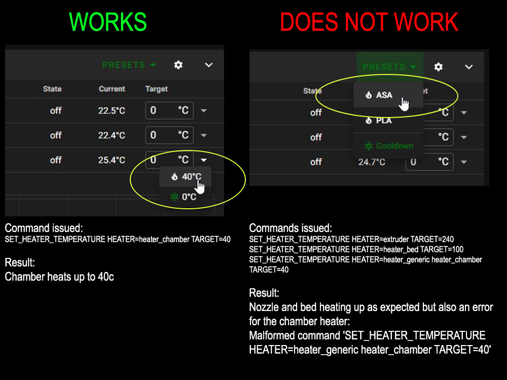

Setting chamber temp via PRESETS gives 'Malformed command'
I’ve set a preset for preheating ASA: nozzle 240, bed 100, chamber 40
If I click on PRESETS → ASA, this is displayed on the console:
Malformed command ‘SET_HEATER_TEMPERATURE HEATER=heater_generic heater_chamber TARGET=40’
SET_HEATER_TEMPERATURE HEATER=heater_bed TARGET=100
SET_HEATER_TEMPERATURE HEATER=extruder TARGET=240
So Klipper was unable to set the chamber temperature…
However, if I select a temperature from the dropdown at the right side to the ‘heater chamber’ line, the command issued is:
SET_HEATER_TEMPERATURE HEATER=heater_chamber TARGET=40
…and this works fine!
So why not when I choose a preset?
It’s obvious that the preset method gives a wrong heater name “heater_generic heater_chamber” since the name is only “heater_chamber”
How to fix this? Is it a bug?
I’ve got no macro’s doing something with temperature…

I’ve just setup a preset for ASA :
Can I alter the way the commands are formed for this preset manually?
I see in the screen shot, the wrong name “heater_generic heater_chamber” is displayed…
Ah right, I added this in the custom G-code section of the preset:
That works, and I’ve unchecked the chamber temperature in the preset…
So it’s a bug then really?
Not to be able to set the chamber temperature in a normal fashion?

No, that does not work. I get:
The value ‘heater_generic heater_chamber’ is not valid for HEATER
What DOES work is:
Also with quotes (both single and double) does work:
SET_HEATER_TEMPERATURE HEATER=“heater_chamber” TARGET=40
Just a visual recap:

Well, if I understood @wd73_NL correctly, then the issue is not about building the command manually.
It is about using the built-in function in the web interface, which seems to be issuing the wrong command.
If my understanding is correct, then this would be a bug in Mainsail and should be reported to GitHub - mainsail-crew/mainsail: Mainsail is the popular web interface for managing and controlling 3D printers with Klipper. (ping @meteyou)
That is exactly the point!
And I didn’t think of it as a Mainsail bug when I posted it here on the group, so that’s my bad. I will post the bug for the Mainsail crew.
So indeed a bu, but not a Klipper bug… can be closed now
Yep, After rereading the whole discussion, I too see that @wd73_NL was using the presets correctly. Sorry @wd73_NL for the misunderstanding.
yeah. this looks like a bug in Mainsail. Thx for opening a issue in the mainsail github repo (this is my todo list). I will check it asap.
