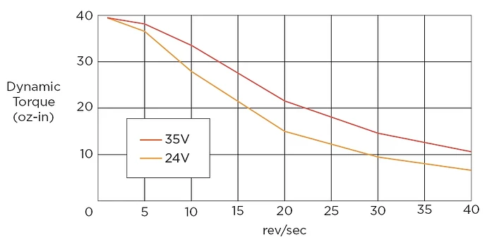

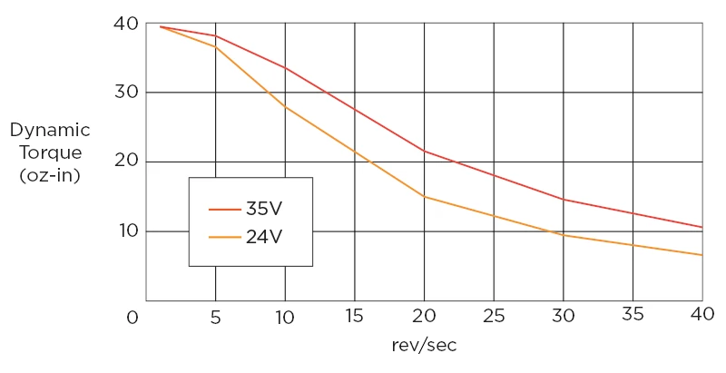

2.5 Supply Voltage
  • Definition: The voltage supplied to stepper drivers - commonly 24V in modern 3D printers.
  • Practical Impact: Higher voltage enables stepper drivers to overcome inductance and back-EMF, supporting higher speeds and torque.
  • Recommendations: Use a 24V (or higher) power supply if supported, especially for low-inductance or 0.9° stepper motors. This is vital for high-speed X/Y or extruder use.
2.6 Rated Motor Voltage
  • Definition: The voltage at which the motor is designed to operate continuously, typically ranging from 2 to 5 V for common stepper motors.
  • Practical Impact: Modern stepper drivers are sophisticated current controllers. They use the high supply voltage (e.g., 24V) and rapidly switch it on and off (a technique called PWM or ‘chopping’) to precisely maintain the target current value. The motor’s low rated voltage (e.g., 2.8 V) is not a supply requirement; rather, it indicates the voltage needed to push the rated current through the coil under simple DC conditions.
  • Recommendations: Use a 24 V (or higher) power supply to give the stepper driver the voltage “headroom” needed for fast current rise and optimal control - especially during rapid accelerations and high-speed movements. The supply voltage should always be significantly higher than the motor’s rated voltage for best performance in 3D printing.

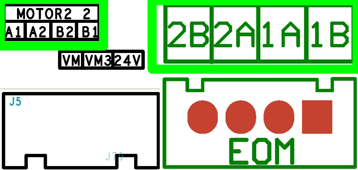

6. Connecting the Motor to the Printer Board
Stepper motor connections in 3D printers are not standardized across brands, boards, or even within one manufacturer. Whenever changing printer boards, motors, or motor cabling, it is essential to carefully verify the wiring assignments to avoid malfunction or hardware damage.
6.1 Motor Phases and Direction
A typical bipolar stepper motor has two phases, each with two wires (total: 4 wires). This configuration is illustrated in the following image:
  • Phases: The two coil pairs (marked with green and orange rectangles) must be correctly connected to the printer board. The sequence of the phases (whether a coil is designated as A or B) does not affect operation, only the rotation direction.
  • Identifying Phases: If the datasheet or manufacturer’s wiring diagram is unavailable, you can determine the coil pairs as follows (with the motor not connected to the board):
    • Digital Multimeter (DMM): Set to resistance mode. The two wires from the same phase will show the winding resistance (typically a few ohms). Unconnected wires will show infinite resistance.
    • Manual Turning: Rotate the motor shaft by hand. Then, short any two wires together and rotate again - if it feels noticeably harder, those two wires form a phase.
  • Polarity and Rotation Direction:
    Polarity within a phase (BLK/GRN respectively RED/BLU) and phase sequence (A/B) define the rotation direction. This can easily be swapped by inverting the direction in firmware (e.g., Klipper’s dir_pin setting) and is not critical to correct at the wiring stage.
6.2 Connector Markings on the Board
Board manufacturers use various notations, most commonly a combination of A/B (or 1/2) and numbers (e.g., A1 A2 B1 B2, or 1A 1B 2A 2B). Markings may differ even within the same brand or board family. The following image shows two different stepper connectors side by side:
  • Phases: The first character in the board labeling typically groups wires by phase.
  • Harnesses: Inspect the motor wire harness carefully - some detachable harnesses internally cross or swap pins. There may not be a direct one-to-one mapping between the connector ends.
6.3 Takeaway
There is no universal wiring standard for stepper motors or printer boards. Double-check all assignments:

8. Advanced: The Importance of Supply Voltage
The supply voltage is key to achieving dynamic and well-controlled stepper motors, yet its importance is often neglected or underestimated. Supply voltage is “consumed” by multiple factors discussed in previous chapters, potentially leaving insufficient voltage to drive the required current through the motor coils.
8.1 Back-EMF
When the motor spins under the stepper driver’s power, its coils cut through magnetic field lines. This movement induces a voltage opposite in direction to the driving voltage, reducing the net voltage across the coils and thus the current. This is called Back-EMF.
  • Faraday’s Law of Electromagnetic Induction: Any change in magnetic flux through a circuit induces an electromotive force (EMF). In motors, this is the voltage generated in the coils as a result of the motor’s rotation in a magnetic field. The amount depends on:
    • Number of turns in the coil
    • Rate of change of magnetic flux (i.e., speed of rotation)
  • Lenz’s Law states that the direction of the induced EMF always opposes the change in magnetic flux that produced it. In motors, this means back-EMF always acts against the applied voltage causing the rotation - hence the term “back” EMF.
  • Back-EMF depends on several factors and increases with:
    • Rotational Speed (\omega): Faster spinning = greater back-EMF.
    • Magnetic Field Strength (\Phi): Stronger magnets = more EMF for a given speed.
    • Number of Turns (N): More coil turns = higher EMF.
    • Motor Geometry/Design (k_e): Shape and structure also affect the outcome.
8.2 Inductive Voltage Drop
A similar effect arises from the pure inductive nature of the motor’s coils. An inductor resists changes in current, requiring additional voltage to force these changes.
Inductive voltage drop is influenced by:
  • Motor inductance
  • Rotation speed of the shaft
  • Motor step angle (e.g., 0.9° or 1.8° - see full_steps_per_rotation in Klipper)

The torque a motor can deliver depends on its rotational speed. Manufacturers illustrate this with a pull-out torque curve, essential for understanding real-world motor performance.
(Source: Stepper motors: is high torque at high speeds possible?)
This curve shows the maximum usable torque at each speed. The decrease in torque at higher speeds is due to voltage losses (mainly back-EMF and inductive effects).
:light_bulb: Important:
For reliable operation, the required torque to move an axis must stay comfortably below the pull-out torque curve. If the required torque at a given speed exceeds available torque, the motor will stall or skip steps - leading to a failed print. Any operating point below the curve is safe.
