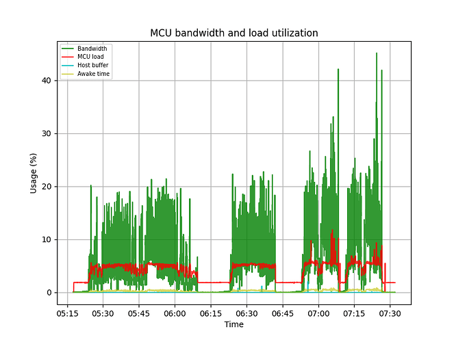

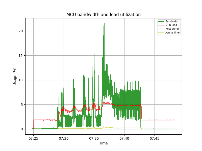

I just figured out that extruder has planetary gearbox … maybe pressure advance is trying to move it too fast … is there a way to limit this somewhere?
what I don’t get is when I graph it I do not see the problem
but printing this cube, 20+ mins in I see this:
what happens that from regular 10-30% ā€œbandwidthā€ same jumps to 1400% ?! always at same place printing this cube ?!
according to this my settings are def. not ā€œtoo fastā€ (speeds and feeds) but what could try to do this crazy move of extruder? PA? input shaping?
