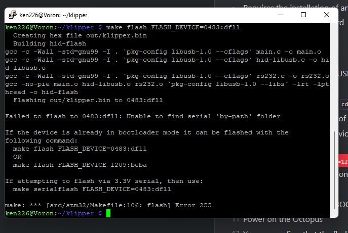

Unable to connect usb to mcu
Printer Model: custom (cr10 copy)
MCU / Printerboard:BTT e3 mini v3
New install on new printer, 64 bit rasp pi and klipperscreen.
Pi/Klipper will not connect to mcu via usb. I an using 64 bit Pi-os

Edit: Looks like your Facebook post got the helping answers already: install 32 bit OS.
But please for future issues attach the klippy.log! :wink:
If you are running Debian Linux an update broke the by-id links that you would use for USB.
Do this command to see if you are running Debian
cat /etc/os-release
If so then this link will fix this problem.
