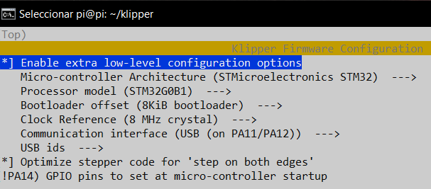

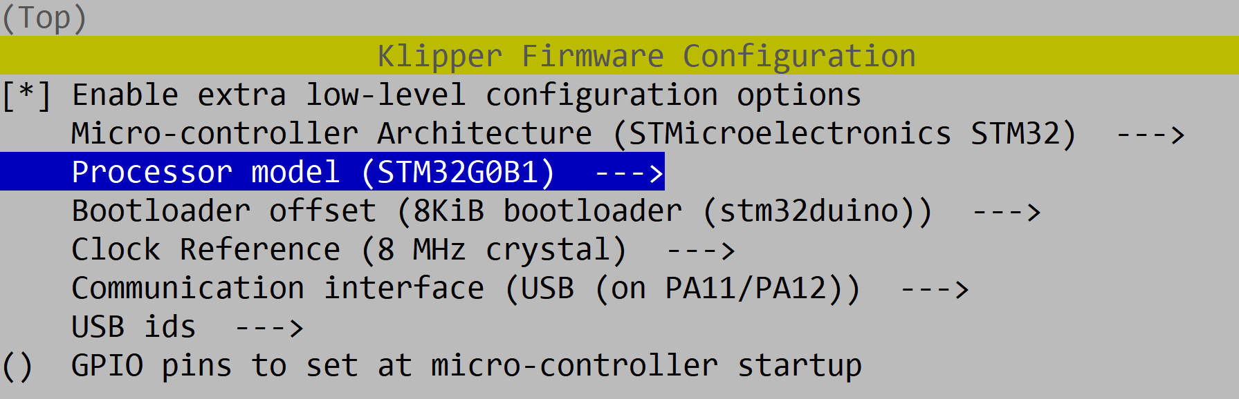

When you compile Klipper for the SKR, can you verify your menuconfig settings?
Once you compile and put klipper.bin on the microSD card, rename it to FIRMWARE.bin, turn off the SKR, plug in the SD card, and turn on the SKR. Then please post the output of:
ls /dev/serial/by-id/*
Hi,
This are the settings:

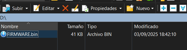

This is me using WinSCP to reach the klipper.bin in out folder and drag it to a 1Gb micro SD card formated in Fat32.
Now i copy it on the sd card and it is renamed as FIRMWARE.bin
