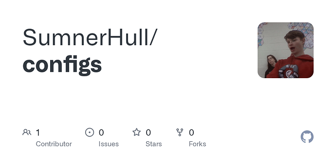

Hello @dumner !
Are these your files?
If yes: It is appreciated to upload files here, if too big they may be zipped. Pleas do not use remote file sharing, even if it is GitHub.
