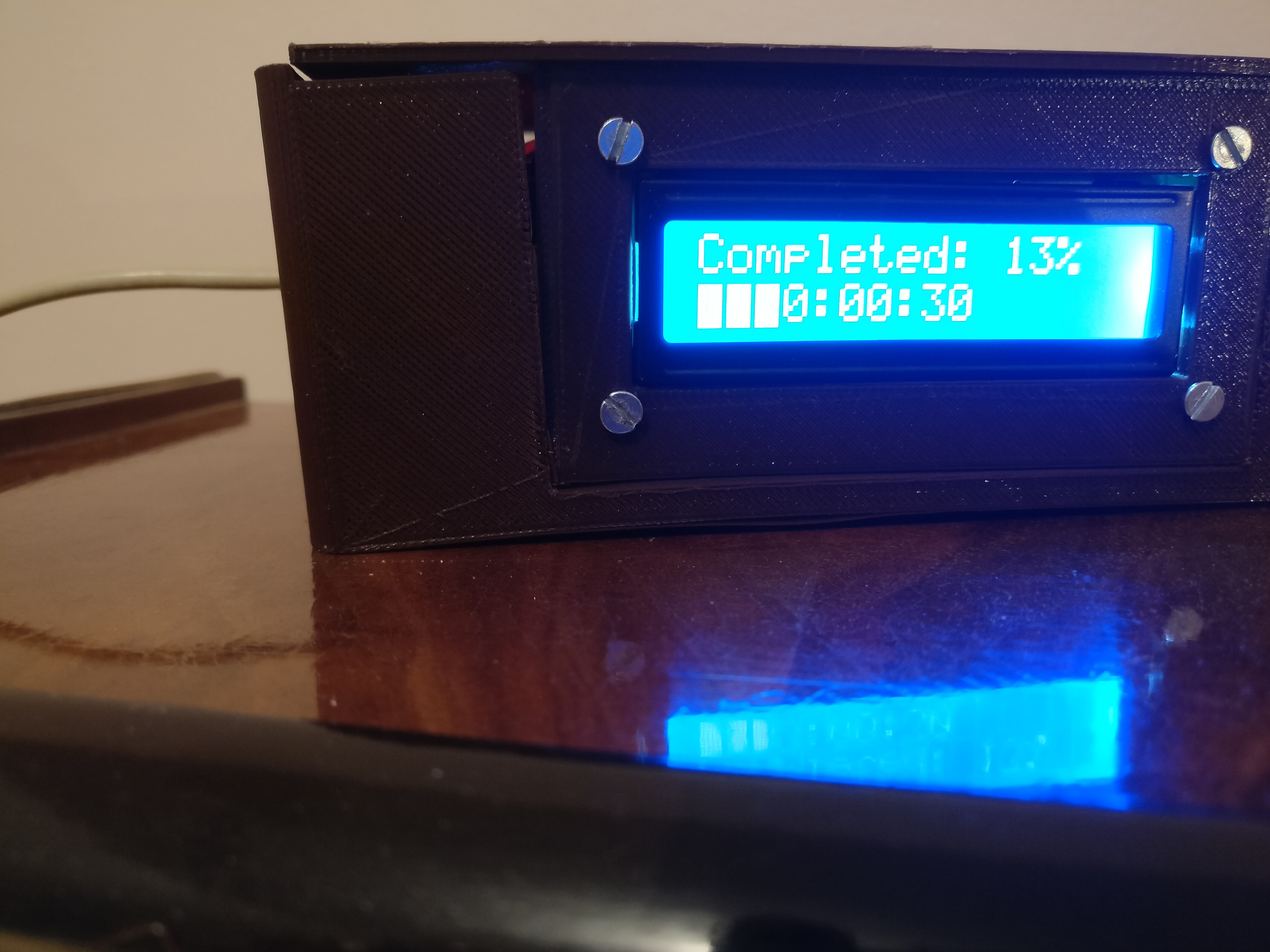

I am using a BTT SKR pico on my diy printer and want to display information (maybe layer number or hotend temperature) on a 16x2 LCD , either connected directly to a Raspberry Pi or an Arduino.
Is it possible to read these data and use it in this way?
Thank you for any advice.

If you run Klipper on OctoPrint and the display has I2C connection, you can use this plugin:
If the display has no I2C, you an put the arduino in between.

You can configure the line length to 16:
https://www.klipper3d.org/Config_Reference.html#hd44780-display
The number of lines is currently fixed at 4, but to my knowledge on a 16x2 display there are simply two invisible lines. So with a proper display.cfg squeezing the necessary information into 2 lines it might work.
You may need to find out which lines are hidden. I have the suspicion that line 1 and 3 are visible and 2 and 4 are hidden, so you will need to configure a blank line between your two visible lines, but I am not certain about this.

I tried all possible options, just could not get it to work at all. :confused:
I can display only the 1st 2 lines on a 20x4 but not on a 16x2.
Will use another type of display instead.
