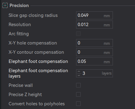

So I just checked Orca and the Arc setting is disabled (which makes sense, I don’t usually use Arc as my print results are of a quality I am happy with):
So are you saying that the GCODE is trying to use ARC commands?
