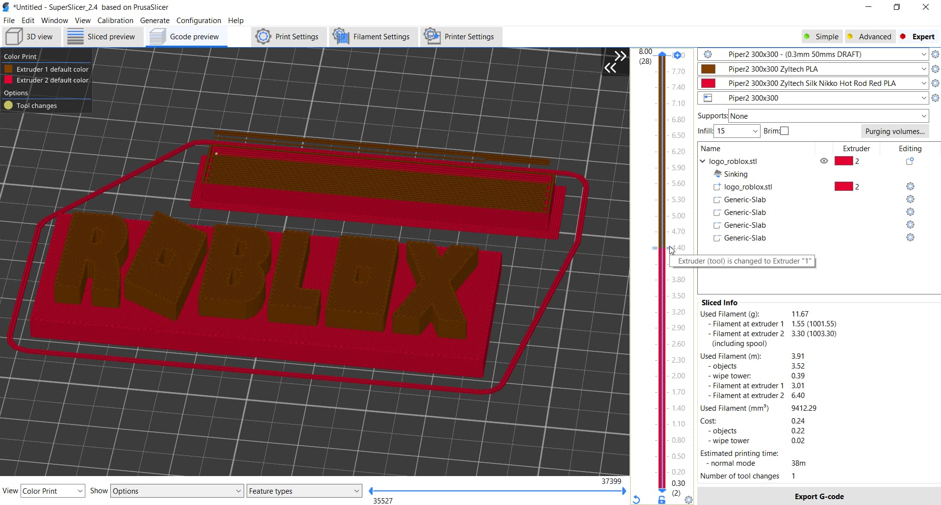

SuperSlicer Setup:
Printer Settings → General
  1. Set the number of Extruder Steppers configured in Klipper. This should be the total number of steppers in [extruder] and [extruder_stepper] objects. My printer has one extruder and one extruder_stepper = 2 extruders in SuperSlicer
  2. Check the Single Extruder Multi Material check box. This should enable additional features
  3. Confirm that the new menu object Single extruder MM setup is visible along with the number of extruder(s). If the new menu is not available, un-check the Single Extruder Multi Material, increase Extruders, an then re-check Single Extruder Multi Material. Once the new menu is visible, adjust Extruders to the correct number of your printer.
Printer Settings → Custom G-code
Add in the appropriate Tool change G-code. Mine is as follows:
;Tool Change g-code.
;PARK, FILAMENT_LOAD2, and CONTINUE macro's replaced with Slicer settings
;PARK
ACTIVATE_EXTRUDER EXTRUDER=[tool_name]
;FILAMENT_LOAD2
;CONTINUE
During a filament swap, I decided to add some extra G-code that provides the following functions:
  1. ACTIVATE_EXTRUDER EXTRUDER=[tool_name] - This does the physical switch between extruder_steppers in FW.
Printer Settings → Single extruder MM setup
Insert the value you determined from the first image above for Cooling tube position and Filament parking position. These values will be explained later on and how they work along with the Extra loading distance value.
Printer Settings → Single extruder MM setup → Advanced wipe tower purge volume calculs
This section is interesting. I’ve activated it and SuperSlicer will automatically generate the purge block based off settings here and per-filament Pigment Percentage value (0-1). Test print was made using a semi-translucent yellow and blue filament, which is a excessive change needing a large purge block.
Nozzle volume: V = π * r2 * h or V = 3.14 * (1.75mm/2)sqd * 25mm. 25mm is approximate measurement from tip to start of heat sink. Default = 120
Multiplier: I set to 120, which is what the Nozzle Volume was. Default = 60
Algorithm: I changed to Hyperbola since it seemed to provide a larger purge block, which was needed due to the selected filaments (translucent yellow and blue).

Print Settings → Multiple extruders
Extruders, Ooze prevention, and Advanced sections will not be addressed in this document. Adjust as you see fit.
Wipe Tower needs to be Enabled and uncheck the Prime all printing extruders for starters. Feel free to adjust the default location of the Wipe tower position. It can be dynamically moved around on the 3D View before slicing. The remaining settings can be adjusted if/as needed.

Example Sliced Model with Tool Change at Layer:
This image is of the sliced model. a simple logo with a color change at a layer. Purge/Wipe block is just to the top.
