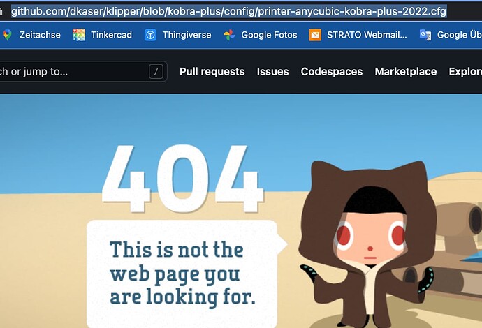

and…unfortunately this cannot be opened here (page not found) :face_with_raised_eyebrow:
can you send me the CFG file again via PN? Please and thanks
Sorry about the link… I rebased that branch to get it ready for the PR, here’s a better link now:
If you’re already running Klipper, then you can just import the config file. The firmware comment is directed at folks that want to revert to Marlin — the modification changes the address of the X stepper, so to go back to Marlin you need a firmware with the address modified too.
I’m guessing that this was a weird combination of two incorrect settings (rotation difference and endstop positions) resulting in a mostly-working config, but then breaking when one was fixed and the other wasn’t. The Kobra uses sensorless homing, the Plus uses endstop switches.
