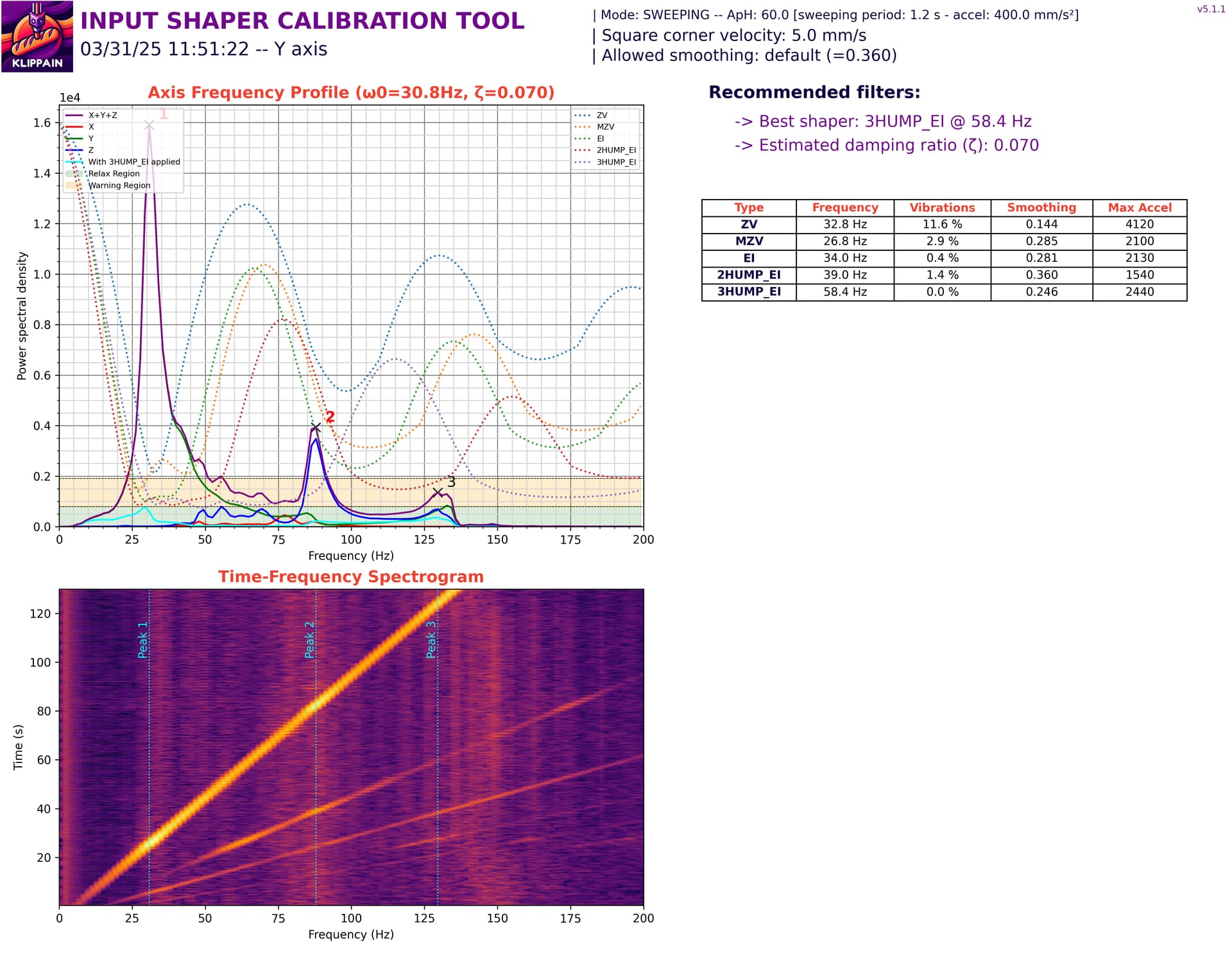

I’ve been struggling for a few months to try and get rid of a ringing pattern on my Y-Axis movements. The pattern wasn’t present on my 3D printer prior to upgrading to Klipper and it started appearing after I began calibrating Input Shaping and Pressure Advance settings.
I’ve checked for mechanical issues and the bed feels rigid (nothing’s lose or wobbly), and it’s fairly smooth to move back and forth. Belt tension also feels ok too, and the input shaping graph doesn’t look too bad so I’m starting to wonder if it may be software related. Perhaps some settings in my config that I haven’t quite mastered or may have set up incorrectly (I read somewhere that bed meshing may affect this but haven’t really tried anything different on that front)?
I’ve tested a few prints with different filament brands (all PLA), and have tried with different microstepping ranges starting at 16 microsteps all the way up to 256 on both SpreadCycle and Stealthchop modes for EZ2209 drivers, and have also tried different input shaping algorithms based on the recommended frequency settings. I found that 256 microstepping on SpreadCycle mode with 3hump_ei or MZV give the smoothest/less noticable results, but the pattern is still clealry visible when turning the print. Here’s a couple of pictures to illustrate the issue:
I’m honestly at the end of my expertise and don’t know what else I can try on this front so any insights are greatly appreciated!

Hello @LifeOfBrian,
I’be gone ahead and ran the Vibrations Profile test. Here’s what it looks like for the X-Axis:
And here’s what it looks like for the Y-Axis:
Not really sure how to interpret these, so any additional thoughts or comments you may have are greatly appreciated!

If you check the upper middle graph (Global speed energy profile) you will see three green speed bands where the vibration energy is the lowest - I cropped those a bit more for Y:
  • 0 - 47 mm/s
  • 70 - 98 mm/s
  • above 150 mm/s
Get the best sweet spots for both axes here.
You should prefere getting your print speeds into those bands. Though I would not consider using above 150 mm/s on a bed slinger but might be worth a test.
Maybe input shaper can get it fixed.
That means you have to set your slicer accordingly. Maybe 45 mm/s for outer perimeter and 95 mm/s for inner perimeter.
Or to test it you can print everything except infill with 45 mm/s.
Be sure to avoid options like slow down on overhangs or other similar settings that can reduce the speed getting it into a bad speed band. That is often a bit tricky to get everything sorted out here.
Your X axis motor has a single resonance frequency but more than 10x more energy there compared to the Y motor. Maybe due to the lighter print head compared to the heavy bed.
If I’m right you are using an acceleration of 400 mm/s²?! You could try increasing this a bit. Maybe to 1000 mm/s² if the belts are properly tensioned. Because the faster your reach the “good” print speeds the less time you are using the “bad” ones.
There are bed slingers with even higher accelerations. Always depending on the particular printer and has to be tested to find the best compromise between quality and print time.
Because the faster you print the more the quality will depend on the input shaping. Meaning you might get rid of those VFAs but get ringing/overshoot the input shaper might not be able to counteract properly. Or you have to use a more smoothing input shaper where you will lose details in your prints.

Ah, the first input shaper screenshot lists 400mm/s² on the top right area. But your klippy.log says 2100mm/s².
So if you are using the latter it might be ok already, just recheck the input shaper settings.

Alright @LifeOfBrian my friend, I’ve got an update for ya!
Here’s what I did:
  1. I changed the µsteps count to 64 for X, Y & Z axes
  2. I installed & set up Klipper TMC Autotune, seems to be working fine although I don’t really know if it’s doing anything outside of shwoing up on the “Vibrations Calibration” profiles :sweat_smile:
  3. I re-tuned input shaping to account for the new micro step values which gave me slighly higher frequency and acceleration values.
  4. I did a re-run of the Vibrations Calibration profiles. Here are the results for X & Y:
  5. I reduced the print speed of the model to 94 mm/s to print “as fast” as I could whilst still being inside the second “safe zone” provided from the vibration profiles.
Overall, the printer appears to be running much quieter and the print came out much smoother. The pattern is still visible in the Y-Direction but at a much lesser capacity than what it was before. I’m gessuing this probably means I need to reduce my print speed closer to the 80-90 mm/s range to move further away from the “upper limit” of zone 2.
So far this seems to be the right approach to fixing the issue, but I guess I’m just a little dissapointed at the fact that I upgraded to Klipper primarily to be able to push for higher printing speeds, but it won’t be a huge improvement from the stock model of the Anycubic Mega Pro if I have to stick to the 80-90 mm/s print speed range… But I guess it’s just a limitation of the hardware/bed slinger profile on this thing.
