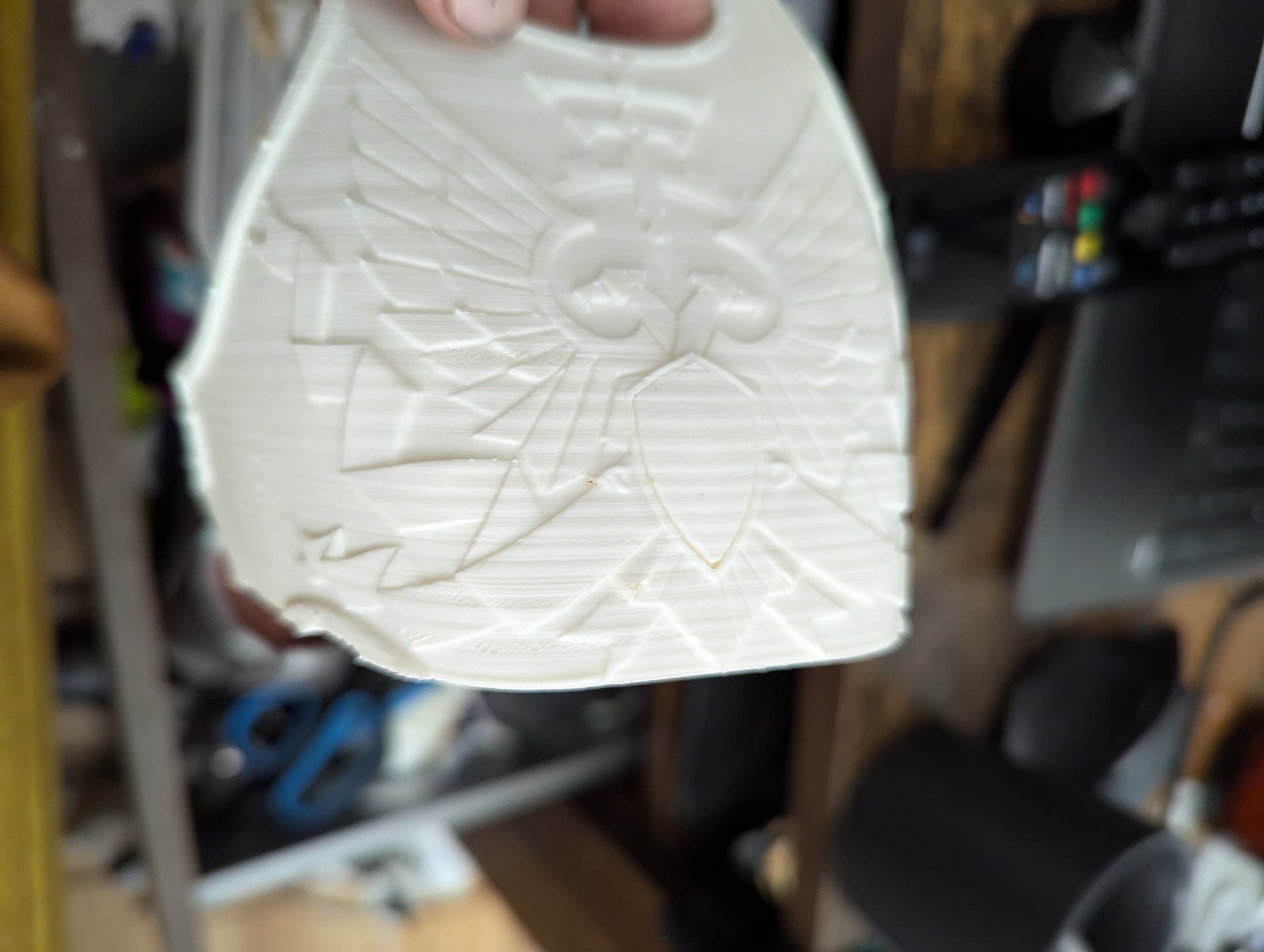

On larger parts and only on larger parts there are repeating layer inconsistency issues present. The more detail there is the stronger the inconsistencies are.
Everything is calibrated and I am into this hobby for almost 10 years:
printer frame is true, e-steps, flow, resonance comp, PA, etc.
Due to the inconsistency pattern I am 100% sure it is not ringing and pretty sure it is not hardware related in general.
I am usually very good at troubleshooting but here I am quite stuck.
Printed in ABS 255°C/100°C at very slow 60 mm/s (usually printing 100mm/s)

I posted this a few days ago and closed it soon after because I thought I had found the underlying issue but sadly this is not the HW issue I thought. Again, I am pretty certain it is a setup issue, maybe to do with PA or resonance compensation.
This issue is only really visible on larger parts with even surfaces so I cant tell how long it has been present. I already tried stepping down acceleration and speeds a lot but nothing changed.
There is also some underextrusion going on I only experience on large parts like this.
I am a calibration/tuning fiend so you can be certain that everything from e-steps, over PA, flow rate, etc. is calibrated as much as possible.
Printed in ABS 255°C/100°C at very slow 60 mm/s (usually printing 100mm/s).
0.3 nozzle, same effect at 0.08 and 0.12 layer heights. Using a Voron M4 extruder with a relatively short bowden tube.
These steps you can clearly see are running parallel to the bed and are equally strong on the faces that run along the X and Y axis.
Not a slicing issue either - the preview shows even layers/surfaces

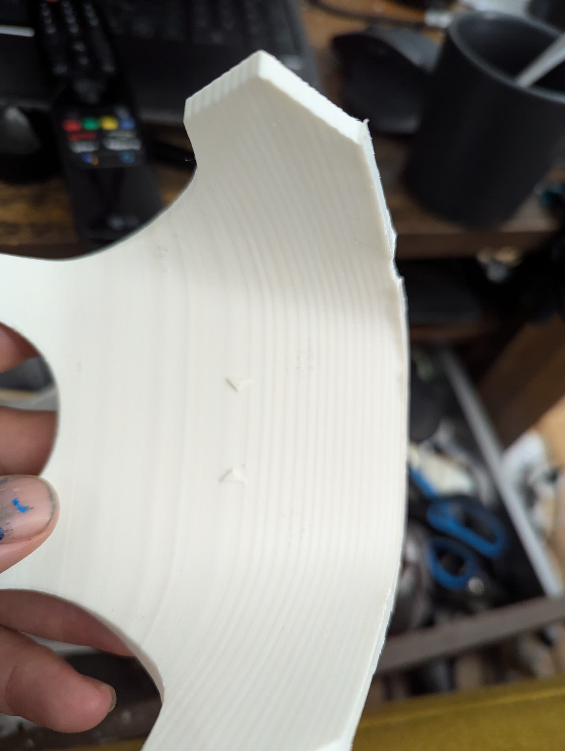

Am I correct in thinking that each of these ridges are multiple layers?
If so I fail to see how a setup issue could cause this. That would point to a mechanical issue for me and would be the first instance I would check.
But do what Sineos suggested, do the same print with PA and RP switched off and see.
If you still have banding, even if it is different, it suggests a mechanical issue.
If the banding has gone it was a setup issue.
If the banding is still there but utterly different, maybe it is a combination of the two.
I would do this check before touching anything else and see. While checking always change only one parameter to eliminate that from the equation.
This print is 8 hours in, input shaper disabled and speed back up at 100 mm/s because speed does not seem to affect it.
As you see the issue it getting less and less pronounced the smaller the footprint of the model gets which is in line with my earlier observation.
What I find very interesting is that each ridge consists of multiple layers and I looks like we are extruding less and less filament with each layer until at a certain point it starts back at zero. On top of the unexplainable pile is that it seems the issue does not only get less pronounced when the model gets smaller, it also looks like the amount of layers each ridge consists of varies quite a lot.

OK, with PA off the issue seems to be less pronounced but I am getting partial underextrusion.
After disassembling the extruder I can confirm that there is no filament grind present and I also rule out a partial clog since there is no underextrusion at all for smaller parts or parts with easier geometry.
I am at a complete loss and would really appreciate any idea!!
In the meantime I tried switching to PLA to rule out warping issues which did not help, I changed the nozzle from 0.3 to a shiny new 0.4 nozzle, I retightend the extruder belt and nothing made a difference. I also did some flow and PA calibration prints which came out flawlessly perfect.
I just cant wrap my head around this: how can it be possible that everything is calibrated, tight and spot on, smaller prints work out nicely (with small I dont mean benchy small but 5x5x5 cm) and only large prints show this issue…

Does it look to be only in one direction or is this photo not showing it correctly?
It looks on this photo that where your red lines are painted in it is much worse then in the direction that is perpendicular. Or is that an optical illusion?

The ridge effect is showing on the x and y faces of the part equally strong and the lines are only running horizontal / parallel to the bed.

OK it looks like I am not stupid and it was not a HW issue after all.
A awesome dude on reddit analyzed the gcode and found that extrusion is completely off for every layer that contains support interface.
Sliced one of the failing models in S3D and and it seems to work.
A stupid bug in cura cost me countless hours of troubleshooting and half a kilo of filament -.-
