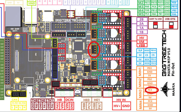

cardoc
December 2, 2025, 6:39pm
18
You have your Z endstop_pin set to ^PC3. Are there wires attached to the MIN3 socket?

Dboy
December 3, 2025, 7:46am
20
I plugged the BL touch into that port but I have not configured it yet as I hoped to configure it when the motors started working
