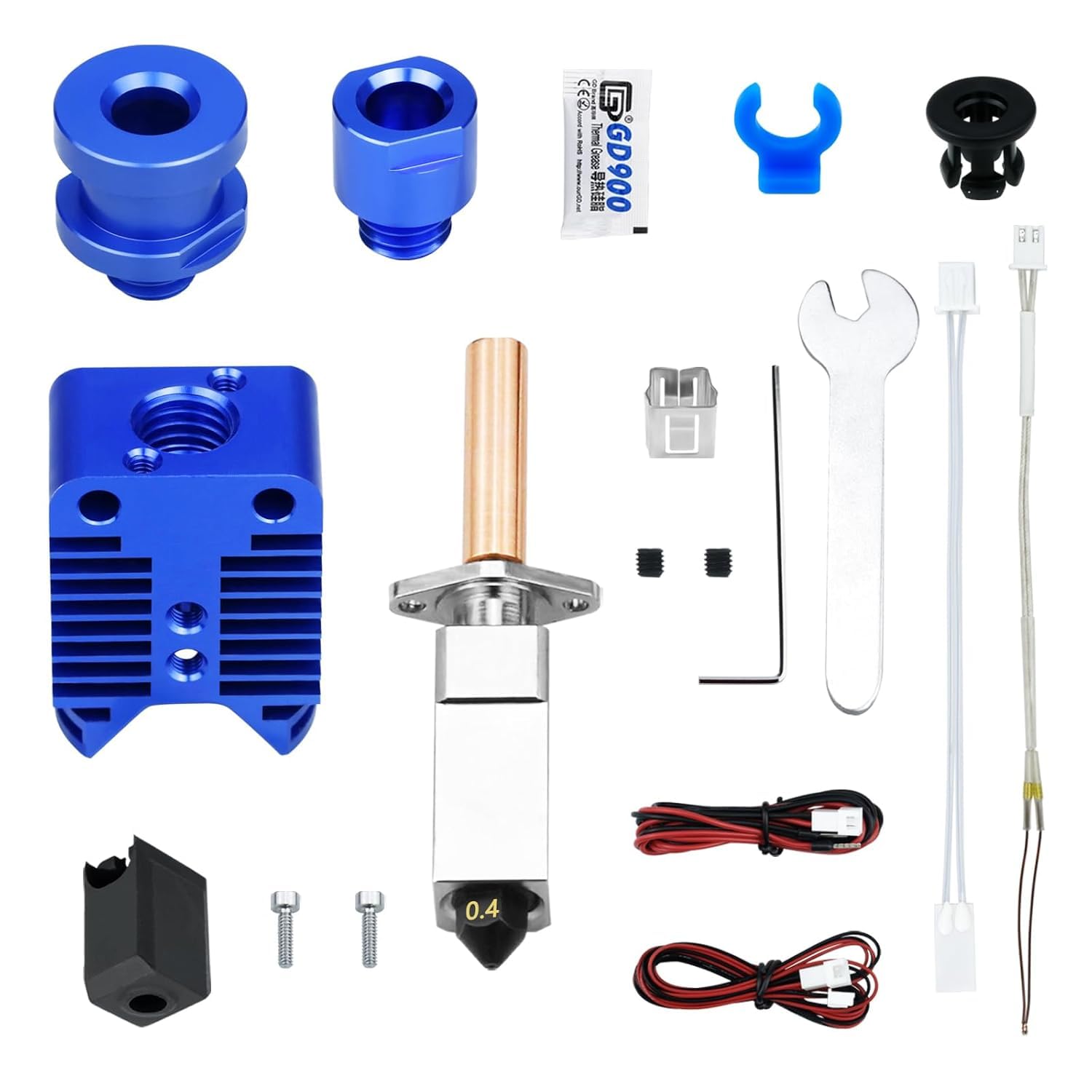

I have an ender 3 v2 + cr touch running klipper mainsail.
Everything has been working fine till i had an issue with my hotend which had a leak wuiith filamenrt all over the heat break and nozzle.
I had a spare hotend whiich i used to replace.. the new hot end was purchased from amazon
here is the link
The new hot end required new cabling to the mainboard which was completed.
When turming on the printer and pi, i get the
followsing error
I have checked and rechecked the connection between the mainboard and the hot end can cannot find anything wrong.
Can anyone please help to advise.
Thanks

That high temperature typically indicates that either the thermistor type is improperly set or thermistor wires are shorted somewhere.
From the product description, you should be using a “NTC 100K MGB18-104F39050L32” sensor_type.

As indicated by @3dcoded. Set correct thermistor type NTC 100K MGB18-104F39050L32

You changed the heater_bed thermistor, not the extruder. I would change your config to:
[heater_bed]
sensor_type: EPCOS 100K B57560G104F
[extruder]
sensor_type: NTC 100K MGB18-104F39050L32
I think I found the issue, I I checked the resistance of the thermostat and it was showing zero so I remove the thermister from the hot end and it looks like it was damaged. Please review the image and confirm this is the case.

The image is a bit fuzzy, but I can see one of the thermistor wires is completely disconnected from the sensor. I would install a replacement thermistor.
Thats correct one of the wires is disconnected from the thermister, this was the oissue all along.
I am trying to get a replacement.
