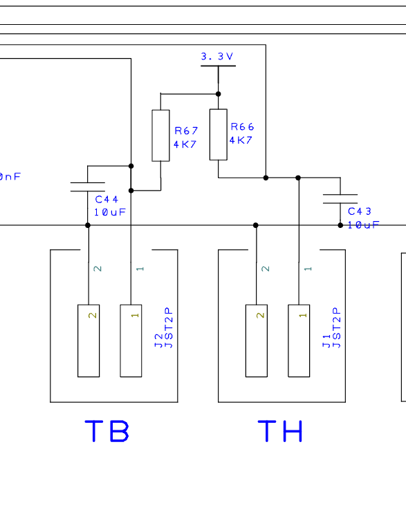

My ender 3 pro shutdown mid print with the error “MCU ‘mcu’ shutdown: ADC out of range" This generally occurs when a heater temperature exceeds its configured min_temp or max_temp” I’ve tried to replacing the hotend thermistor (both read with multimeter at ~120 k ohm) with no success. I have probed both R66 and R67, of which R66 is normal at 4.7k ohm. However R67 reads 100 ohm, the printer have run for hundreds of hours, im just wondering how this happened and if i can simply solder another SMD resistor to bring back functionality

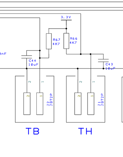

I just tried probing the bed thermistor aswell, it’s at 100k ohm which as far as i can read should be fine. I’ll try to update Klipper later. I found a schematic of the 4.2.7 board that you had posted some years ago Creality Board 4.2.2 and 4.2.7 Schematics and from what i can tell, the voltage divider of R66 and R67 is likely the culprit if the values you provied are correct
This would be the first time that I see a defect here. I consider this as pretty unlikely. Much more likely is a fault in the thermistor, its cable or connector.

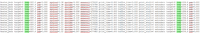

Just for diagnostic purposes, set some insane min and max temperatures and provide a new klippy.log please.

The new log is here
klippy_newpobe.log (1.2 MB)
While the printer was running i tried to remove and reinsert both probes, but the temperature remained the same.
Further I tried to probe the resistance between TH + and - aswell as TB + and -. The Resistance on TB was only 2 ohm while the one on TH was 4.7 kohm. Which then makes sense why the temperature remains high regardless of the thermistor as there must be a shortened connection on the TB.

There is something very fishy going on. As you can see, the bed shows around 587 °C, while the extruder shows 184 °C. Both without a set target and both without any PWM activity.
The bed could really be a short, but the extruder is strange. It could be a wrong thermistor setting as @EddyMI3D pointed out.

As for the schematics, this is no voltage divider. It’s just two pull ups for TB and TH each.
You are correct that was a mistake on my part
The thermistor forms the rest of the voltage divider.
Assuming the thermistor is 100k Ohms the voltage measured from pin 1 to pin 2 should be
3.3V * (100/147) or 2.24V. If your meter has a low impedance (rare in 2025) it will load the circuit and pull the volts lower.
With the thermistor unplugged you should read 3.3V

Without being entirely certain I suspect that the short of the bed is causing a parallel to ground greatly reducing the current/ voltage drop in the hot end leading to a bad reading, mostly based on the constant temperature no matter if the hotend thermistor is connected or not. Feel free to correct me on this though :slight_smile:

I unsoldered both the C44 capacitor and R67 resistor and a short remained on the board, i couldn’t see any other connections on the physical board. I belive the Stm32f103 might have shorted, and im not gonna attempt to replace that.
