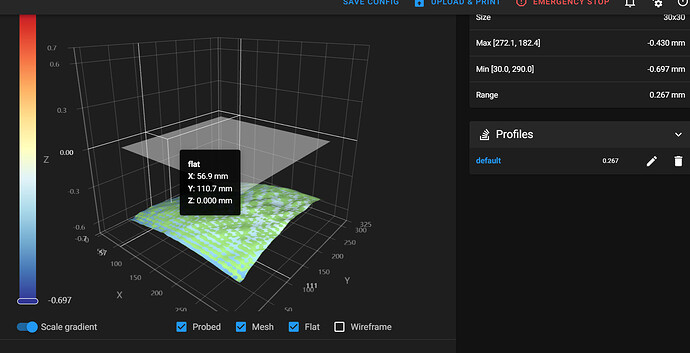

After reboot I do a G28. Z offset is set to 5mm as defined in printer.cfg and also hitting 5.00mm exactlz.
Then I did screw_tilt_adjust and leveled the platform. G28 another time shows now a different value.
And also the heightmap plane is far off.
Second question: How will Klipper handle the first layer? Will it compenate the 0.5mm now? Or doesn’t have it an effect at all?
I just dont understand why Klipper shows me this strange z differential even after homing.

Yeah thanks I know the reference manual well and I usually perform z_offset_apply and safe config command to dial in my printer.
However even after save_config I see this (its small because bed mesh calibrate adaptive=1 is set in this up to date Klipper machine).
After reboot the plane will intersect with the mesh.
This is my question.
Did you understand my question?
Or do you assume I have no idea how Klipper works and I should go to the reference manual?
