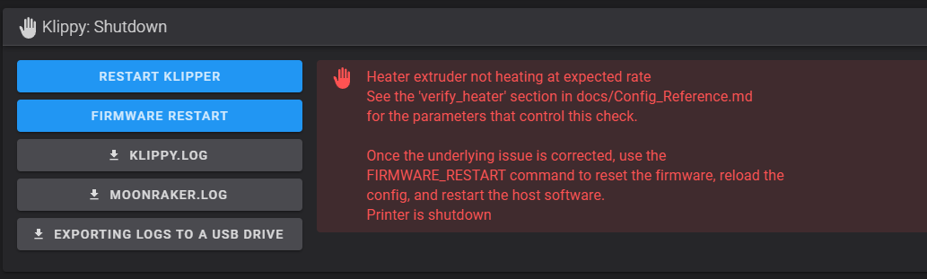

Its saying that the heater is no heating at expected rate.
I tried changing the hot end (all in one unit thermistor/nozzle/heating cartridge) , I tried changing the back board on the head still nothing , I tried to resliced the file ( 4 times ) still nothing.
When I try to set the bed to 80 and nozzle at 240 , its staying very steady and normal at the desire temperature but as soon as I select the file to print, the hole web interface freezes and its giving me the screenshotted error.
It`s something I can try/check or should i say that the motherboard is somehow toaste?

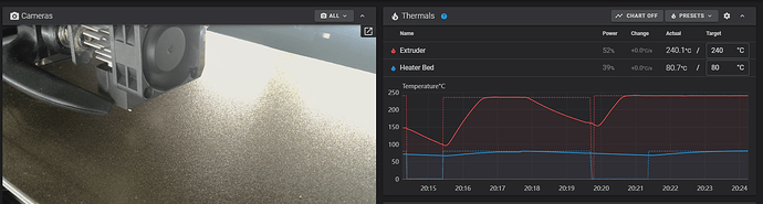

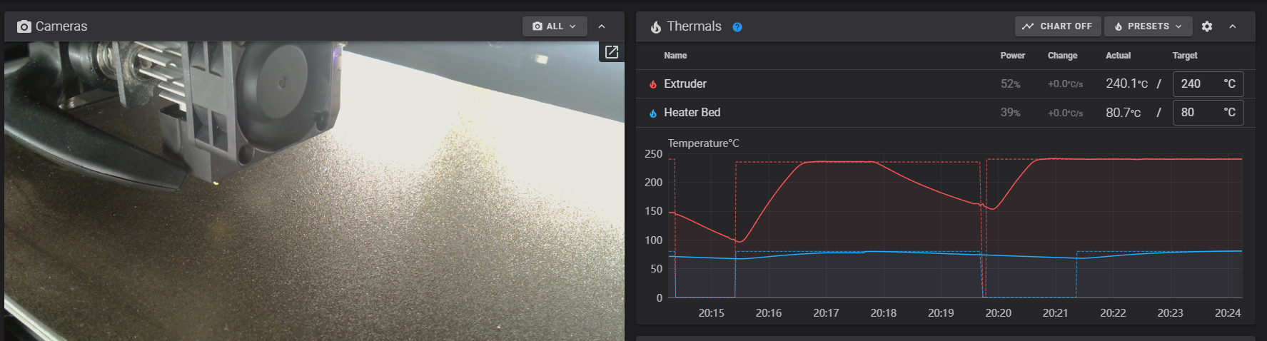

What temperature does it read now?
Will it preheat without starting a print?
Yes I can preheat it manually from the web interface.
But after I select the File and try to print it it`s starting to go mad and freeze.

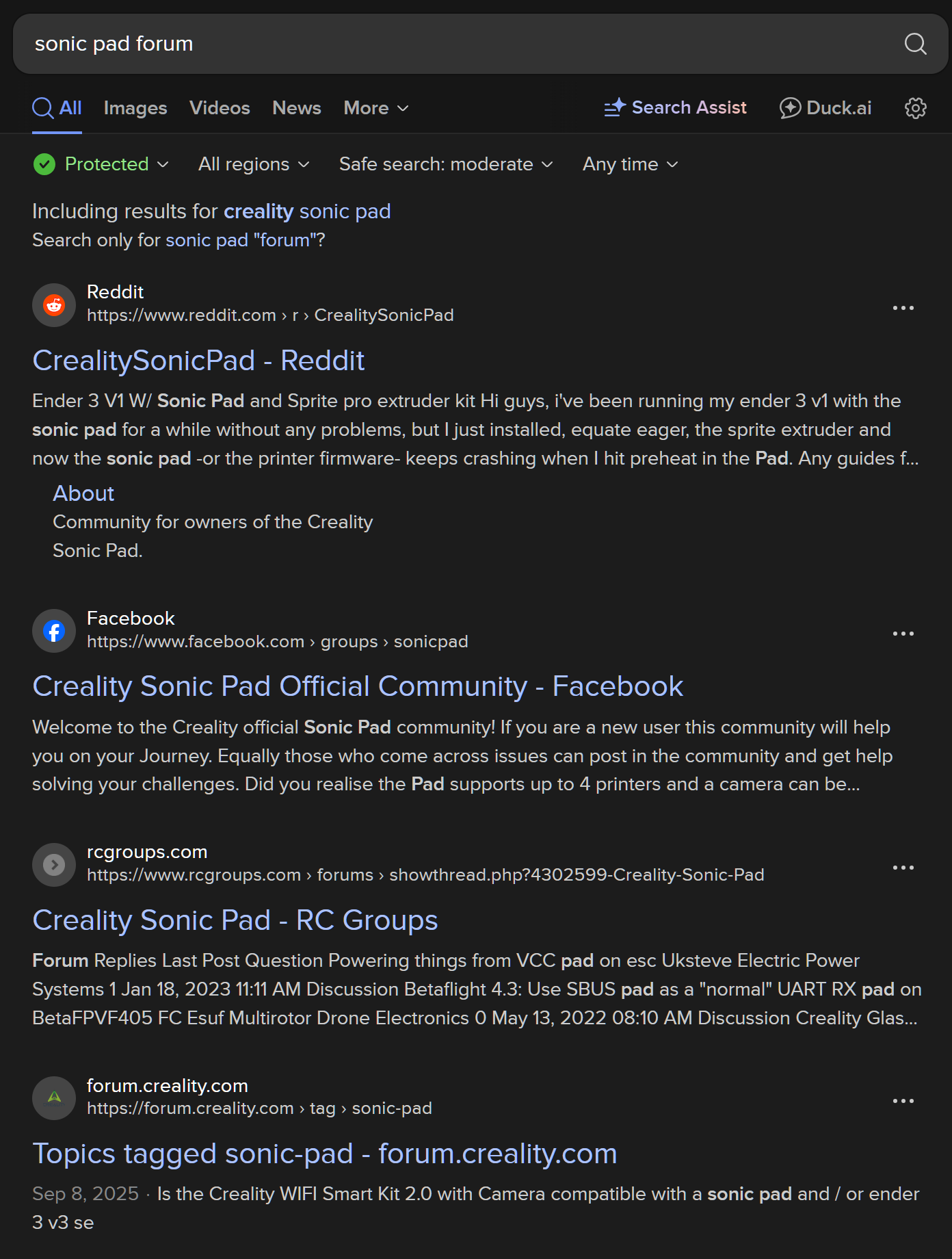

This is a community forum (that does get read by some Klipper developers) about plain vanilla Klipper.
You could easily find a forum for the sonic pad.
Complaining here about Creality’s lack of support is worse than useless.
First I tried to google it and found the Klipper forum Ive seen other peoples with different printers having the same issue. I tried their fixes but didn`t change anything.
I`m sorry I didn`t come here to complain about the Creality lack of support I just figured since the sonic pad runs a Klipper instance this forum could help me somehow troubleshot the error better.
Again I`m really sorry, I didn`t mean to offend or insult anybody. I will try the Sonic forum for help there, but I starting to believe that my next printer will be a Voron...
