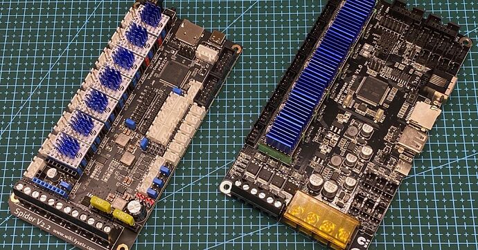

Thanks, if you were to buy the board, which ones would you buy?
Something like a BTT Kraken?
I don’t have any personal experience with any of the candidates. I find the documentation for the MKS to be VERY slightly better. I know of no issues with any of them that would narrow the field. BTT has more market share so forums like this may be more helpful if you have issues.
Don’t forget the driver boards (7 needed). OR buy 2 BTT SKR Mini E3 (4 TMC2209 soldered on) and forget the 8 motor board. Klipper will happily sync up the 2 MCUs and run everything.
As for the Pi I’d pop for a Raspberry Pi 5. It’s considerably more powerful than absolutely necessary but that insures it’ll last several future Klipper versions.
