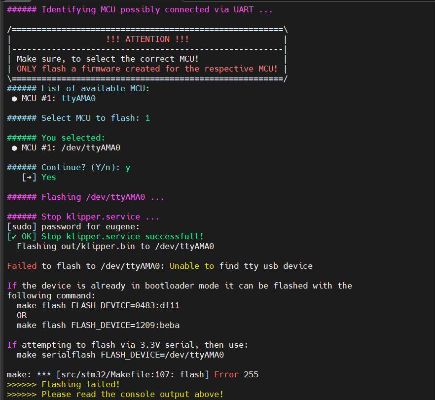

Creality Ender 3-S1
Stock MCU (STM32F401)
Raspberry Pi 3B+
Flashing Won’t work
When I flash the MCU I get this
I tried everything that I could, but it still won’t work.
If more Info is needed just let me know
(I’m also new to all of this so I appreciate the help)
Sineos
2
If it is your first time installing Klipper, then you need to flash via SD card.
