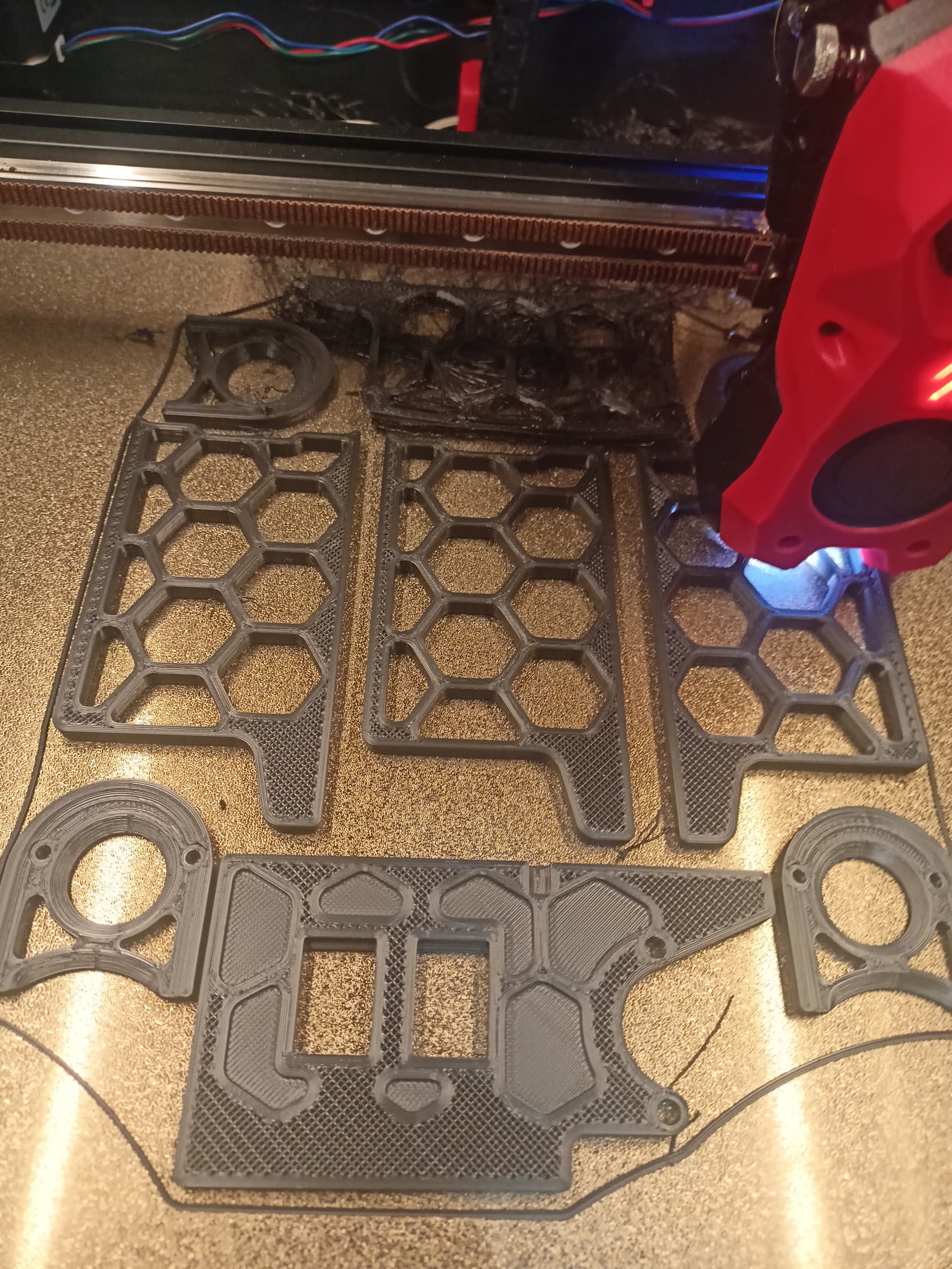

I added coolers to the processor of the mks skipr and improved ventilation and I no longer have a “timer too close” problem for the moment :slight_smile:
A little photo to show you
