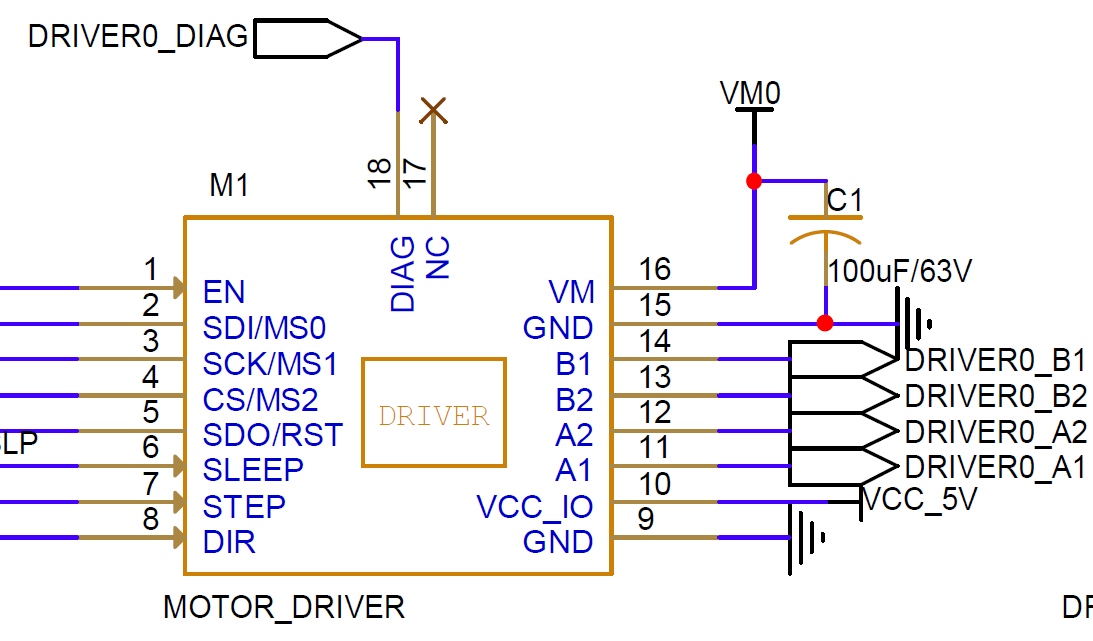

Have you validated the pin order of the motor cable, meaning the 2A 2B 1B 1A stuff?
According to their schematic, A and B are the coil pairs
This is a good suggestion that had not occurred to me yet, during rebuilding I have changed some cables and not checked if they were the same orientation, I assumed all my cables were the same.
I will check this tomorrow morning first thing and let you know.
