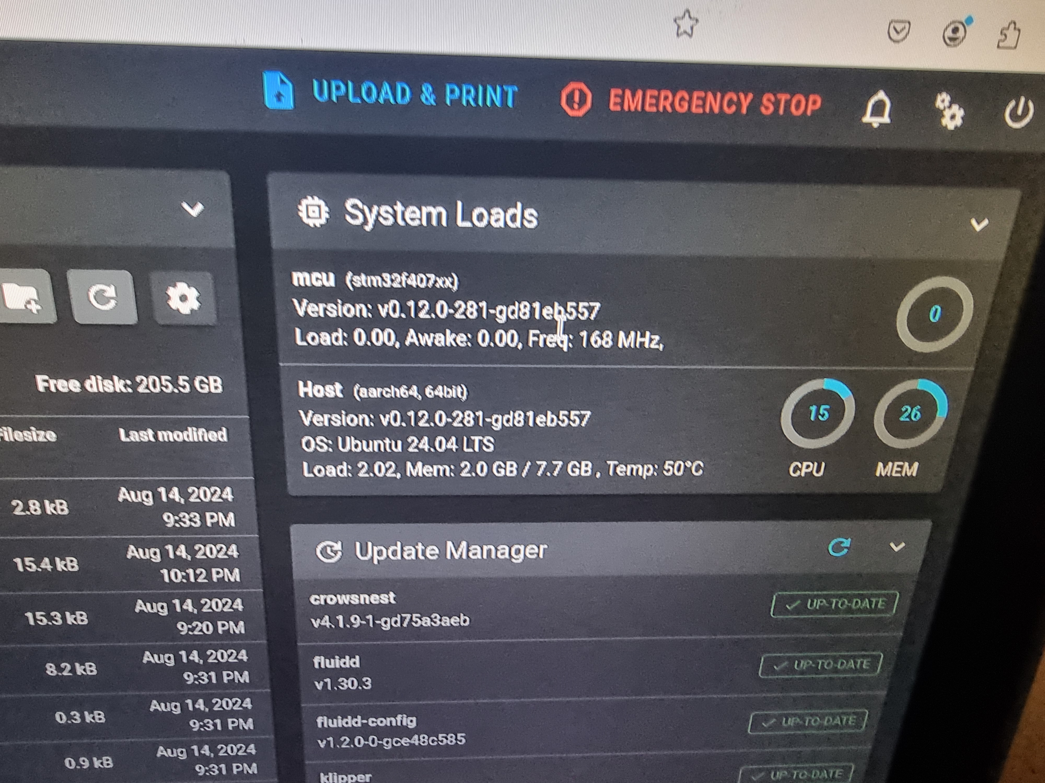

i just installed klipper on raspberry pi and skr pro 1.2
but it cant detect mcu
i tried few ways but they didnt help
my os is ubuntu i dont know its because of that or something else but it doesnt have /dev/serial

hi
im using raspberry pi 5 8gb
with ubuntu as os
and usb connection
idont think klippr.log is the problem because i cant find the board at the first place
i tested that on windows system to ans window didnt recognize any connection
can i use can bus ord uart with ubuntu and raspberry pi ?

In the second two connection attempts, for your connection, you’re using:
[mcu]
serial = /dev/serial/by-id/usb-Klipper_Klipper_firmware_12345-if00
How did you verify that is correct?
Did you use:
lsusb
i didnt
as i said i didnt config anything it was just a test
i tryed using ttl to usb convertor within works very well thank
but still when I set usb and connect the board directly with usb cables Linux cant identify it
