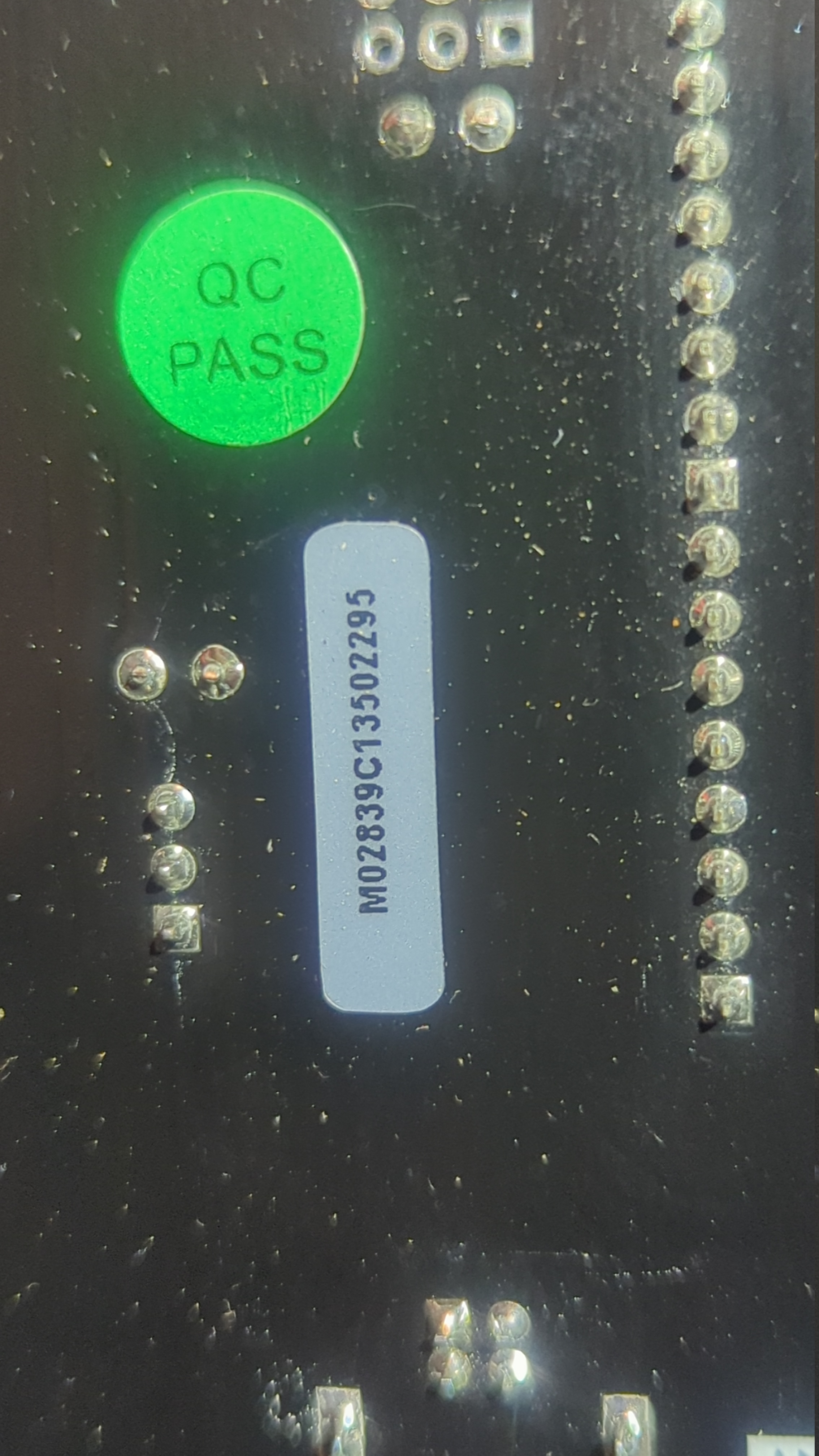

According to this blog I’ve got a trigorilla 1.0 board in the chiron.
These are the only markings on the rear of the board:
M02839C13502295
A quick search returned no hits for that number. Searched with & without “trigorilla.”
Sticker closeup:
Don’t put in “(DOT)” - having the link that you can just click on is helpful.
Anyway, when I look at the wiki and compare it to your photograph:
I cannot conclusively say that you have a Trigorilla 1.0 board:
The Trigorilla (1.0) as identified has the “TM” mark by the Trigorilla logo whereas yours has the Registered Mark (“®”) symbol. I don’t know how significant that is.
